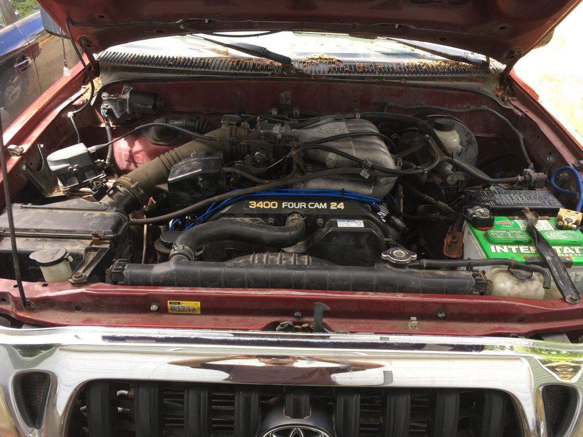

I left the truck in the hand of another person for a year. An the battery was taken out during this time. I returned tried starting the truck an the alarm started going off truck wont turn over but still cranks. I do smell gas under the intake after trying to start for a good 6 seconds. First time posting. Ive been searching for my factory alarm under the dash no luck.

Yes it is cranking i have placed the battery on a duralast 10 amp charger not sure how efficient that is. I turned my headlights on high an tried starting an they do dim slightly but the crank maintains

Sounds like a bad battery
Yeah.... I’d probably start with a new battery like @OR17TRD said. Start simple first. You can take the old one in and wipe out the core charge fee. It’ll probably need a new one anyway (especially once it turns cold outside) since it’s sat for that long.
Routine maintenance like plugs, wires, fuel filter, air filter wouldn’t be bad (or expensive either). And after sitting it’ll need done eventually just for a routine tune up.
