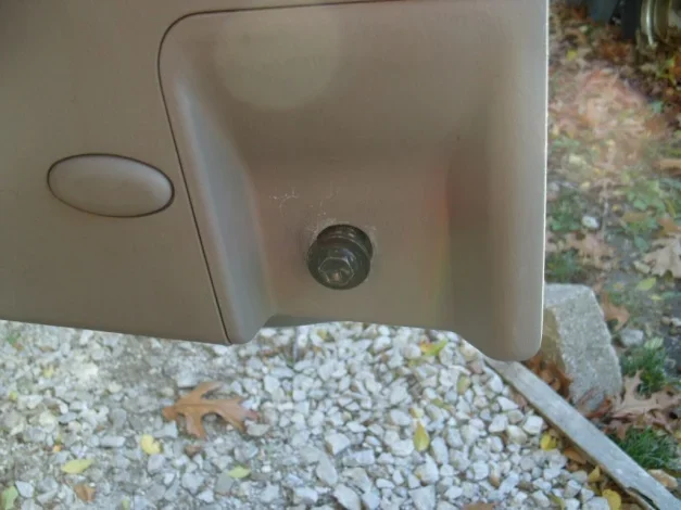

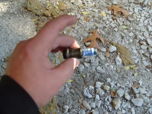

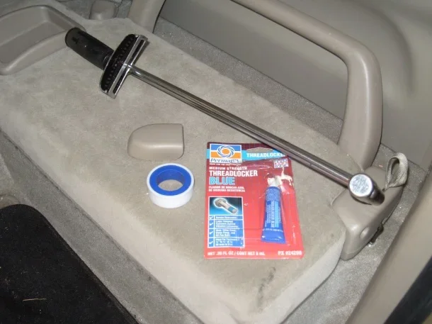

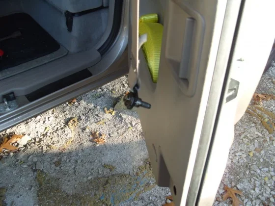

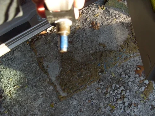

How annoying, noticed my belt was coming loose again so this time a little more permanent fix. Loctite blue, teflon tape, 14mm socket, torque wrench & torque that puppy down to 100 lbs. Took 5 mins to do. If it comes loose again I'll take it in and say your turn Toyota. I do have the recall letter.

Because blue was all I had onhand. Didn't feel like driving somewhere just to get red.
I smothered the bolt with blue, screwed it in, then back out, wrapped it with teflon tape, added more blue and then torqued it down to 100 ft lbs so it should stay tight.

I used a little blue & a couple of wraps of teflon. Maybe .20¢ worth of product I had bought earlier this year and about 5 mins of my time. Wonder what the going rate is for 5 mins of one's time. :shifty:
