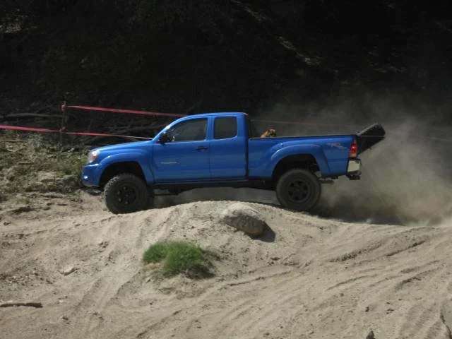

Let’s see some pictures of this taco.
Brand is Tiregate. I had to reinforce the bed of the truck, had to get some welds done after a while because the weight of the tire caused some stress fractures.
