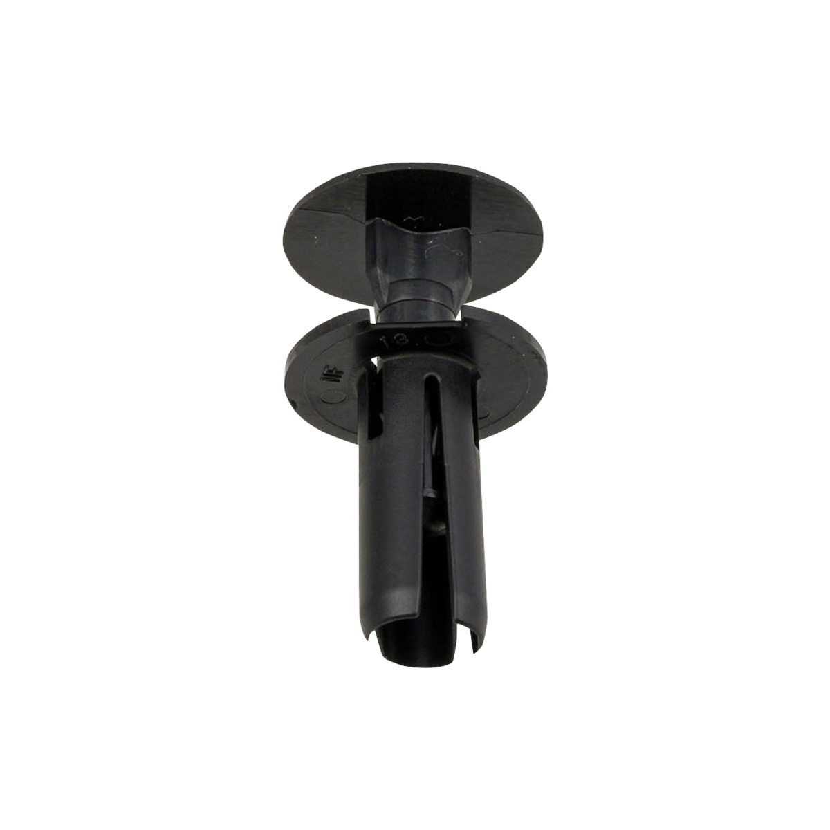

The push clips are two pieces. Take out the center then the clip. I have had the husky flaps on my last two trucks. Take alook at them. You can sell your OEM ones on eBay and get the huskys and make a little money too. They are shorter and don't hit everything.

I took mine off and clearance is better and makes truck appearance better too. Be careful with push clips cause I broke a few of mine. Easy removal though.
The clips are dirt cheap at the dealer, I had to replace 5 that were missing on mine. PN 90467-07188 $1.18 ea.
lol that's why im leaving mine on :laughing: :thumbsup:
Yeah, not sure why I had 5 missing 2 on each rear and 1 front driver. It was like that when I bought it so got tired of looking at the empty holes so got what I needed. :blink:

Hard material with dumb clips and screw combo
Clips break after awhile
