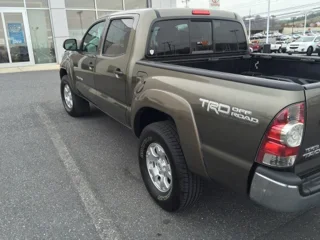

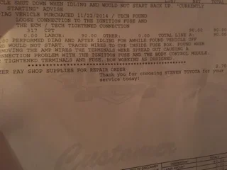

Just bought a certified used 2013 Tacoma 6 cyl auto 4x4 25k miles. Drove it less than a week and while waiting for my wife in the store the truck sputtered and just died. I called toyotacare and less than an hour later the tow truck came. The truck will turn over but won't start.
Next day at the dealer the truck starts right up and it threw no codes.
Dealer said my extended warranty doesn't kick in till 30 days lol so my warranty and my extended warranty is no good. But back to the topic, any ideas what might cause the truck to just quit like that and start back up after it sits? Thanks -TraceyImageUploadedByTaco Forum1416851459.084640.jpg
After an hour of running at idle the service department was able to confirm the truck shut off and not able to restart. They asked to keep the truck another day for more testing. -Tracey
