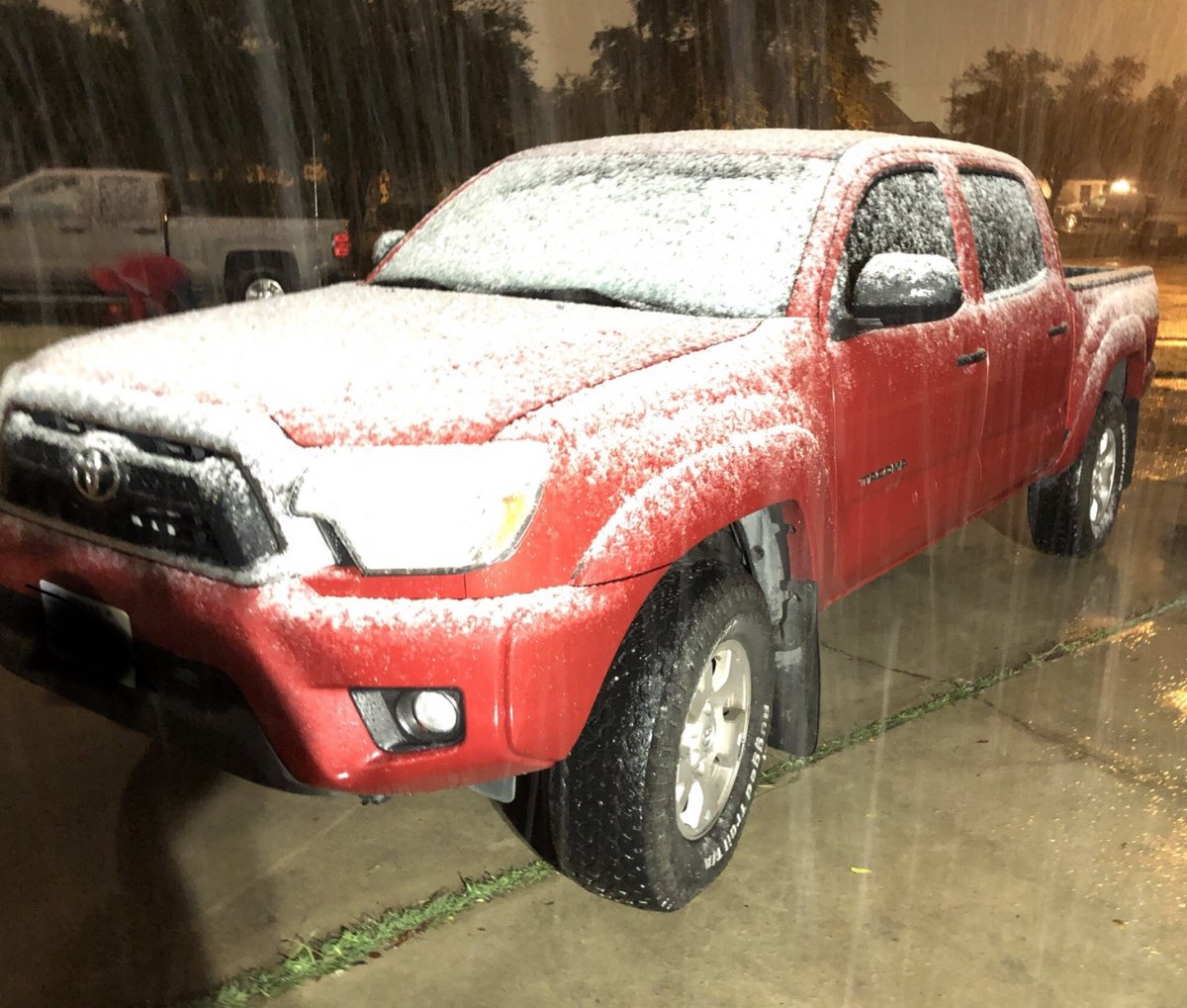

Hey y’all, new to this forum and this is my first Tacoma. I’m wanting to lift the truck. Right now I have a 2014 Tacoma TRD Off Road 4x4. I’m researching into who suspension lift would be best. I mainly use the truck for daily driving, going to the beach here in South Texas and going fishing in some pretty secluded places. I don’t do any Rock crawling so I don’t need something too crazy extravagant just something that will keep the ride similar to or better then stock. I am lookin at anything from 2.5” - 4“ lift. What are y’all using? What should I stay away from? Anything I might need to add to my lift for better ride? Any and all info is appreciated thanks! Pic is back when it snowed down here earlier in the year! 53440838833__D0A4AE91-8238-45D0-BB4E-E93A2539B9B3.JPG
