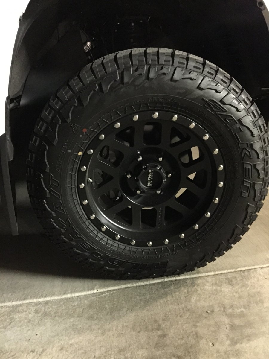

2014 Trd Sport charcoal grey

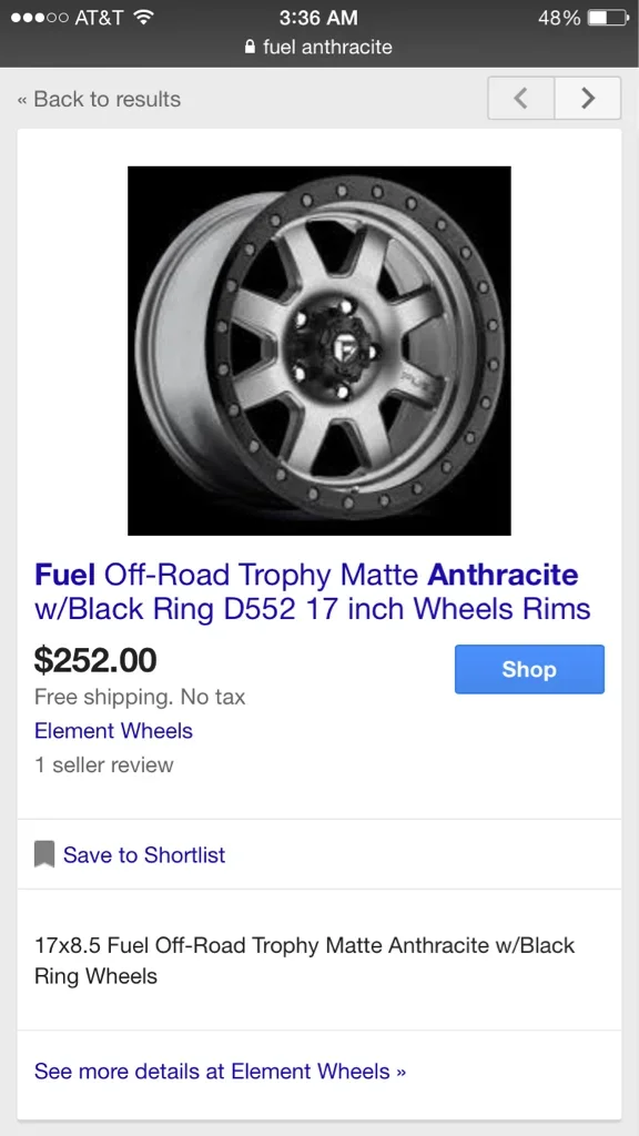

These would probably look amazing on your truck, but may not be your style. I know the lug pattern is different, but they make these in 6 on 5.5, just wanted to do a quick search for you.

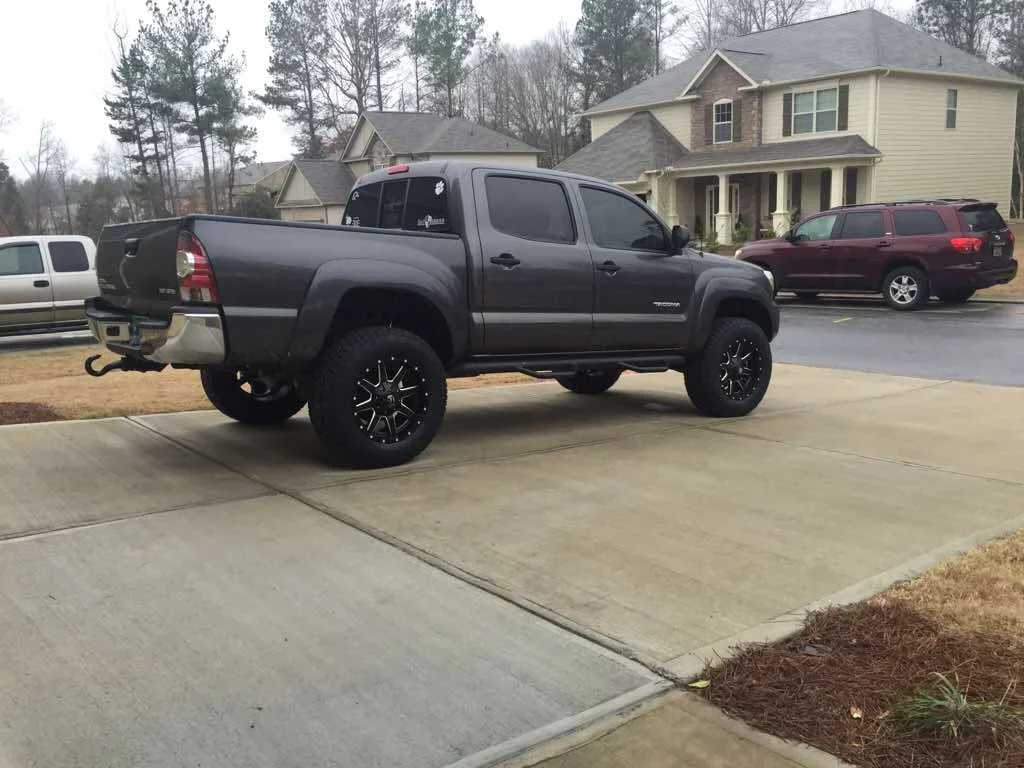

This is a buddy of mines truck. I like black and machine finish the best. Definitely get a Negative offset wheel (more beefy look). I prefer 265/70/18 but 275/65/18 doesn't look bad. I would avoid anything 285 bc it rides like crap. If you want more tire go with the 18x9. If you want a more city look (don't ask) you can go with 265/70/20 which doesn't look bad. It also depends on if you go with a lift. You'll need Atleast a 3" in order to fit comfortably any tire size lifted above.
Also you can get a 33x12.50 tire but it will scrub unless you run spacers which i avoid also. So you have many ideas out there you can do. I went the 265/70/18 with 18x9 (-12 mm offset) gear wheels with Hercules terra trac II A/T tire. Good luck and party hard.

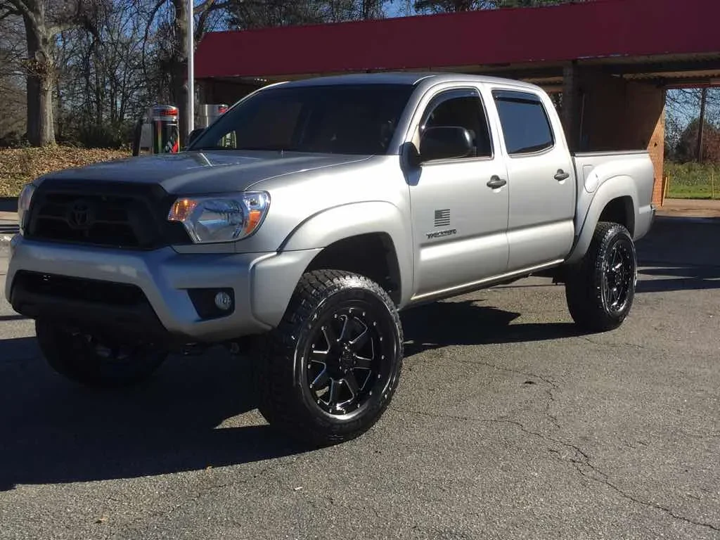

You should be able to get away with that. That's a lot of tread wall so be aware of what kinda tire you run. I prefer the 18 rim over the 17. It's a little wider (depending on the option you run)

By city look you mean the mall crawlers who never go off road
Hey josshyyyy or warakes how high did you raise it? That's how high I want my truck.
I bought it used and came with a level kit. I’m guessing it’s a 2” on the front and 1.5” on the back but not 100%. Looks close to level on level surface. I personally like the front a little higher but I can deal with level lol
