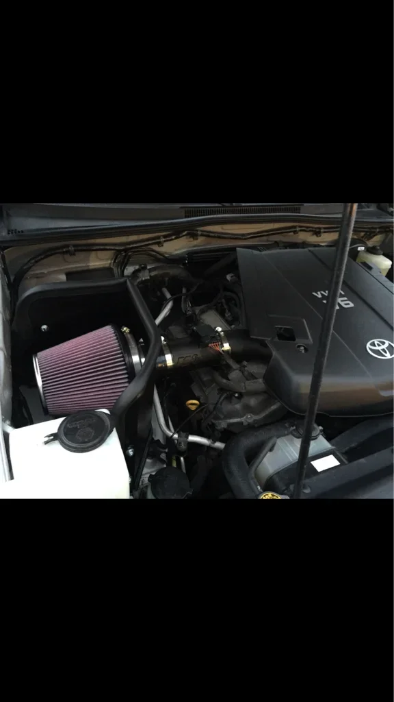

Well I give you a few thoughts. I always do two things when I buy a new truck. Air intake and larger diameter exhaust. It can be as simple as a drop it cleanable air filter. Or complete intake which is what I do. I also just tried this week using 91 or 93 octane gas whichever is in your area. I use 87 usually. Truck had noticeably better acceleration, especially from a stop. This was in the new 3.5 in my 16. ImageUploadedByTaco Forum1468070871.416403.jpg

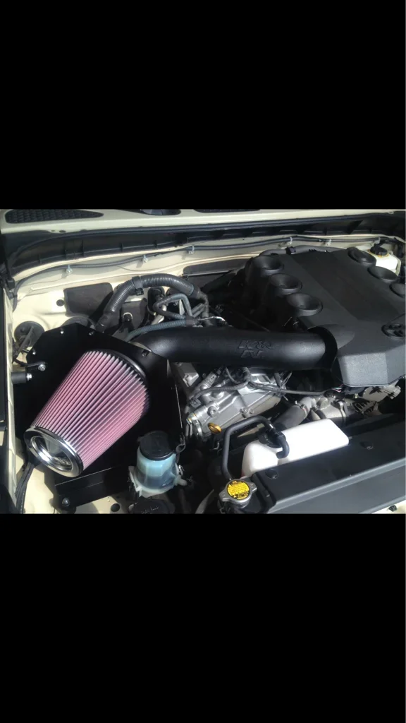

This is in my 07, not much for my 16 yet. Just put a drop in K&N in it. People will say on here any oil filters will mess with the Mass Air Flow Sensor. That's bullshit. Had a K&N on my 2010 FJ, drove 188,000 no problems. Whatever you do enjoy!
