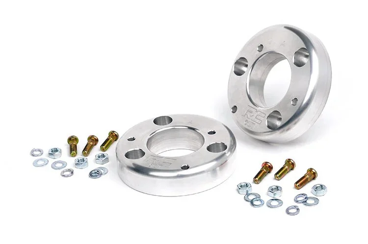

Strut extension?
Like a spacer?
And blocks, to increase axle wrap and deform the already weak springs?
A progressive aal will be more compliant than stock and avoid the block issues i pointed out. I dont understand why u think an aal isnt compliant.
Slowpoke here is a picture sir.
