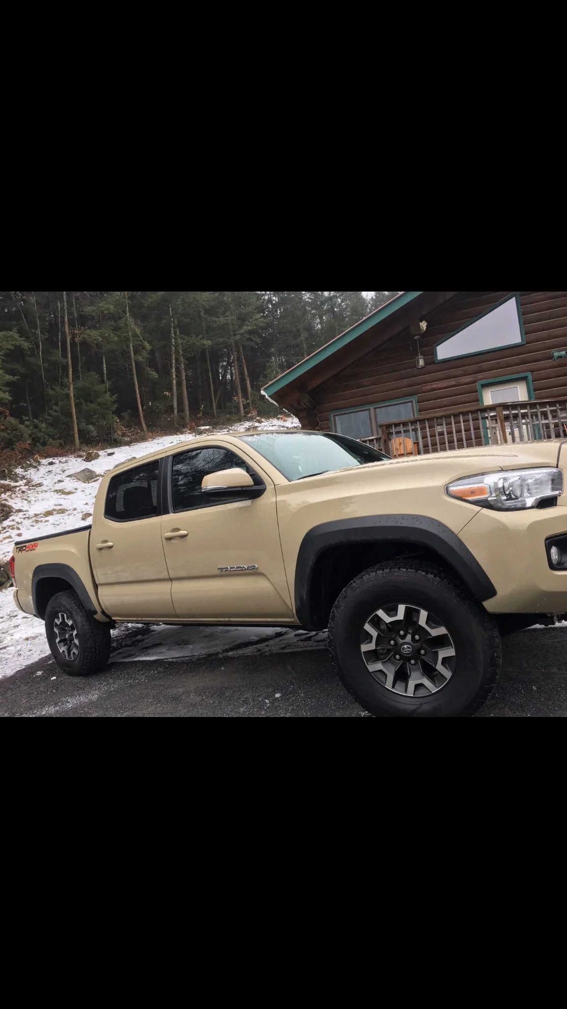

265 75 r16 on factory off road wheels

According to GPS my speedo is right on with the 265 75 r16 so I'm guessing it was a little high before but I never checked it while stock

Dam didn’t think about that. I’m open to other Comparable tires and performance. Do you have pics of your set up?
