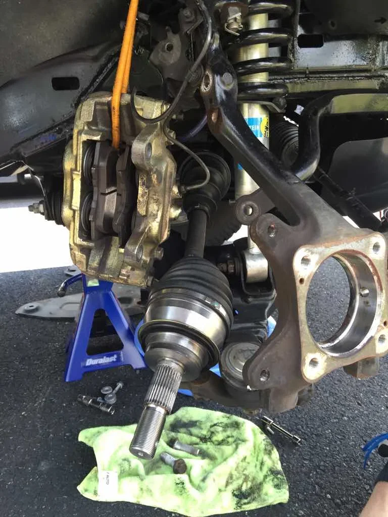

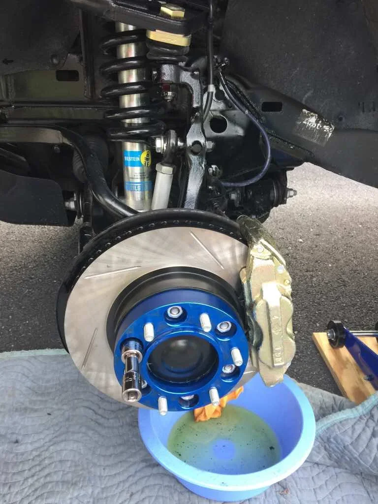

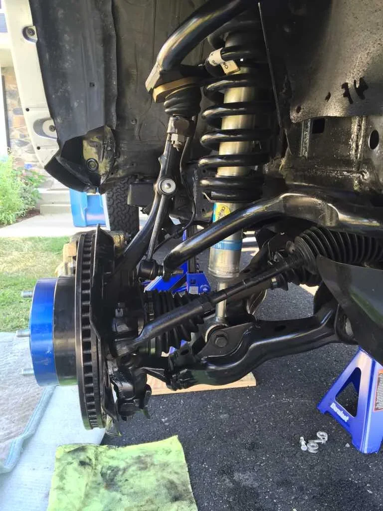

Axles, bearing hub assemblies, rotors, calipers, Upper and Lower control arms, Bilsteins, 886 OME Springs . Search online might be a video someone made .

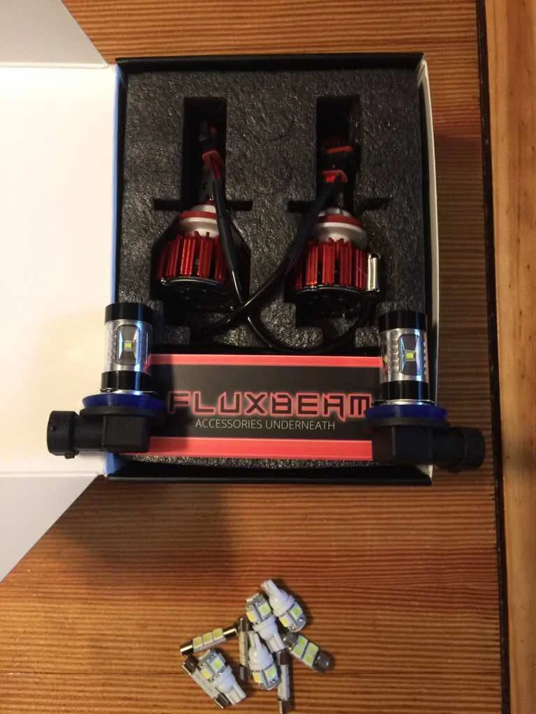

I also replaced all my lights with opt 7 flux beams there the only way to go
The install was easy for the fogs I just opens the hood and reached down there there is plenty of room and twisted the bulb and out it poped and I pulled it up as far as its wires let me and I plugged in the new ones and reached down there and twisted it back on took me 5 min
