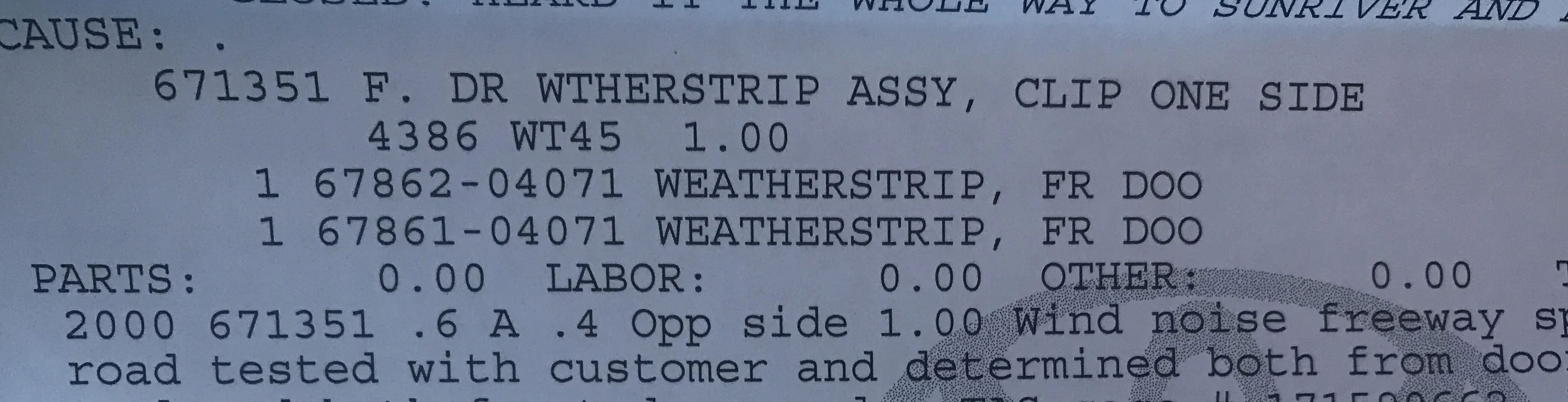

I have had that whistling noise in my 2016 Tacoma since I bought it. Front the driver side door, up in the top corner by the windshield. I finally found a dealer who fixed it. The replaced the doors seal on both sides with part numbers:
6786104062 - weatherstrip
6786204062 - weatherstrip
I have had that whistling noise in my 2016 Tacoma since I bought it at speeds above 55 miles a hour, usually with a crosswind. On the front driver side door, up in the top corner by the windshield. I finally found a dealer who fixed it. They replaced the doors seals/weatherstrip on both sides with part numbers:
The new weatherstrips have an extra rubber piece in the v channel of the weatherstrip to create a better seal.
Hope this helps some of you. Sorry for the double post.

Pls don't fall into the lie that the dealership has a new tsb updated weather strip because I am here to imform u that what they have done is only added a dam piece of rubber tube and super glued it onto the channel of weather strip their intention was for me to never find out of their short cuts and this is an unexcetable fix it only makes me very mad that they try to trick people, they need to have a real fix and not just take a short cut hoping that people just stay quiet and forget about the problem well if you all know these trucks are not cheap, so if further problems arise pls contact ur States Attorney General and file a complaint!!!!!!!!!!!!!!!!!!!!!!! Pls check closely on their fixes because they don't have one, don't be fooled check all the channels for added rubber tubes, Foams, ect, its like placing a bandage onto a broken axel that is not a real fix!!!!!!!! They will try to get away with it I could not believe this until they kept trying to trick me with the fix over and over well now im going to file the worst reviews for them all over the internet and hire an attorney and also file a complaint with the States Attorney General.

I was at the dealer today talking to the regional tech about issues.
Talked about how I have a strong wind noise at hwy speeds and its worse with cross winds. He told me they made new weather stripping that is being installed on the newer 2017 and all the 2018 will have them. He's checking to see if mine was manufactured before they figured this out. He didn't say anything about a TSB. Does any one have an actual TSB#.
Sounds like they know it was an issue and fixed it on newer models and as 2016/2017 customers come in and complain they are replacing the weather stripping but not under a TSB. Just under warranty.
Am I wrong? TSB#? Anyone?
After living with this annoying vibrating reed noise at the top of the front door seals every time I drive into/against a cross wind for 18 mos/25,000 mi. I decided to fix this myself.
Toyo has yet to extend their TSB for 2014/15 for the same issue on 2016s. ( sounds like 2107 do the same ). It was a 5 min. fix and cost $3.50.
If you look at the front door seals along the top and roll them away from the door just a bit you'll see a big gap behind them.
Run down to your favorite hardware store and find some 3/8 or 1/2" round tubular closed cell weather striping with the adhesive tape attached.
Cut a piece long enough to run from the top rear corner were the existing door seal is glued to the door frame down to about even with the mirror.
Peel off about 6" of the adhesive tape cover and fit the new seal into the channel behind the door seal allowing the glue edge to stick to the door frame.
Work your way down the door 4 to 6" at a time until done. This eliminated all door squealing for me and has no door leaks. Easy fix.
