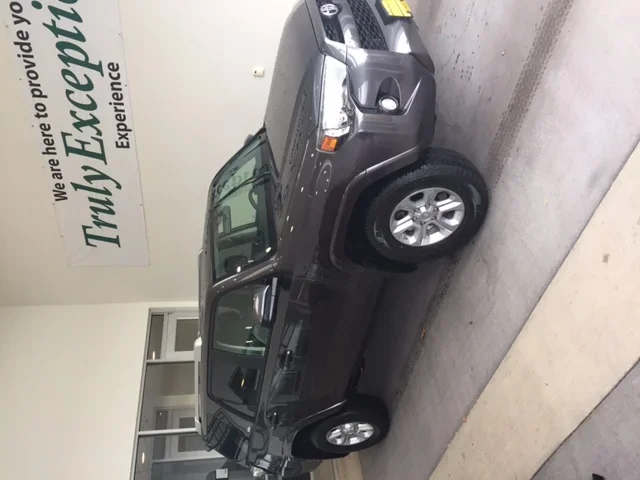

IMG_6937.JPG I had enough of the Tacoma and found the best resolution to all of the combine problems I had with the truck including the sunroof. And here it is.
I guess I won't be posting any more on this forum. Everyone stay safe and hopefully you don't have a lemon sitting in your driveway like I did. I got lubed in the corn hole pretty good but I figure the amount of blood pressure medication I would have bought over the next few years would have been more expensive than just getting a new vehicle.
