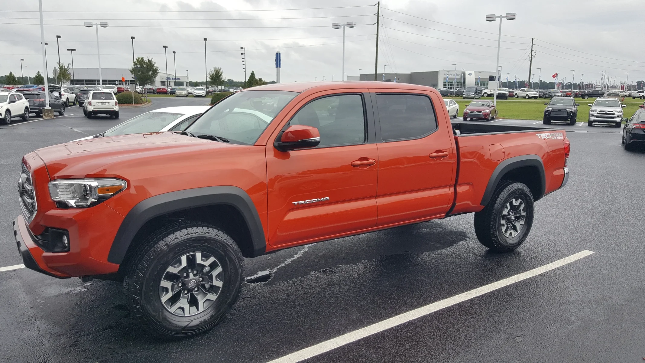

I am new to the forum and wanted to try and gather some more information as to what could be happening with my new Tacoma and the jerkiness I am feeling within the throttle/shifting. I purchased a new 2017 Tacoma TRD OR LB on labor day weekend this year and have progressively noticed a jerky feel in the vehicle when trying to keep a constant speed (really noticable at 45 and then again around 70 mph). It feels as though the engine is misfiring or the transmission is jumping in and out of gear (not sure which), but when I get down on the throttle it is un-noticable. I have also taken my truck to the dealership where I was informed there was a known issue, but after checking the tech said that I had the most up-to-date software for the transmission and there is nothing further he can do.
I've read other threads on similar issues and find it very hard to believe that Toyota has gone this long without really fixing the problem. I had a 2010 Tacoma Sport that shifted extremely smooth and no issues, a 2013 Tundra (again awesome truck but gas mileage sucked), and ontop of that I just bought my wife a 2017 4Runner a month ago and it drives/shifts like a dream. When did Toyota screw up their best selling truck and not seem to give a crap about it?truck.jpg
