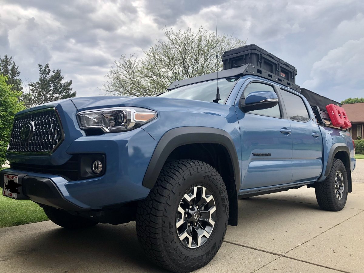

To answer your can you fit bigger tires on stock rims. Yes you can go up to a 265/75/R16 without any issues. I’ve heard of some being able to go narrower and put 255/85/R16 tires on, but your tire selection is much more limited. That size would be around 33” tall and around 10” wide. To go to a wider 33” (and not rub) you will need at least 2 of the following. A lift, wheels with ~4.5” backspace or trim some of the body/plastic. I don’t know the specifics as I’m in the process of getting my ome lift as we speak but I plan to go with Method 703/704 wheels which hopefully will allow me to run 285/70/R17 without having to cut or trim.
Here’s my rig with my 265/75/R16Falken Wildpeak AT3Ws
Really nice setup, I like how the wildpeaks look on the tacoma makes the wheel pop out more. What rack do you have on top? I decided to stick with the stock tires 265/70/16 and now about to pull the trigger on Stealth Custom series F5 in black. I do like the style and also they are lighter. I do already have a Hardtop Tonneau Cover to keep my rods in. Do you have a cover in the bed under the rack?
Thanks! I have a Victory 4x4 Roof Rack. It’s basically a prinsu rack very similar. And yes I have a tonneau cover under my rack. It’s a sliding one. Retrax
