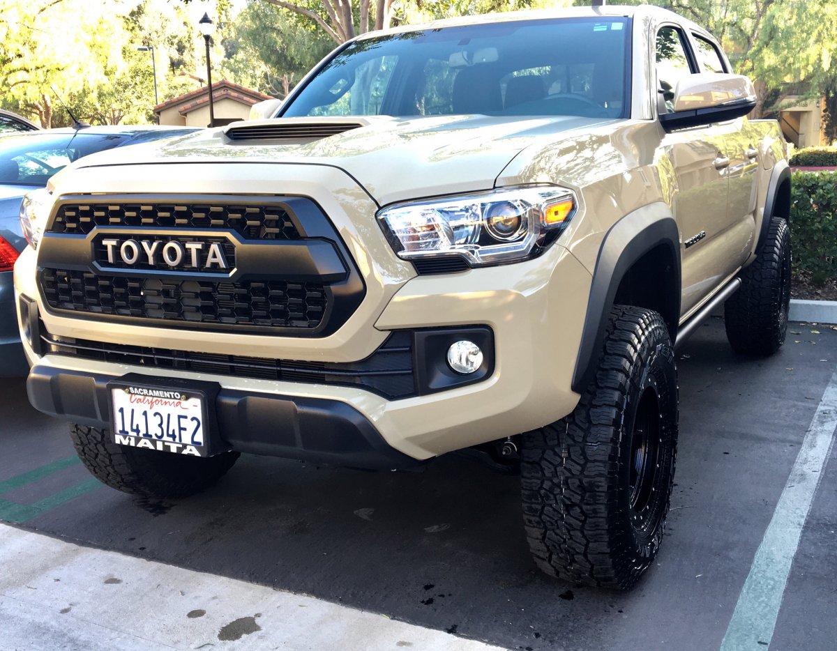

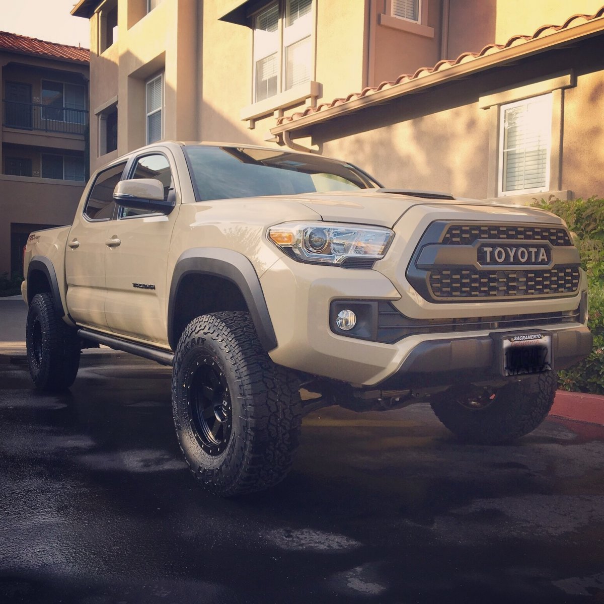

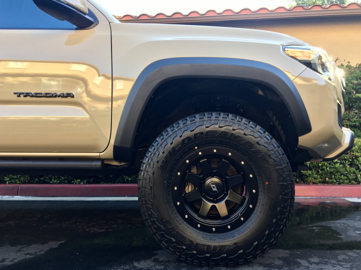

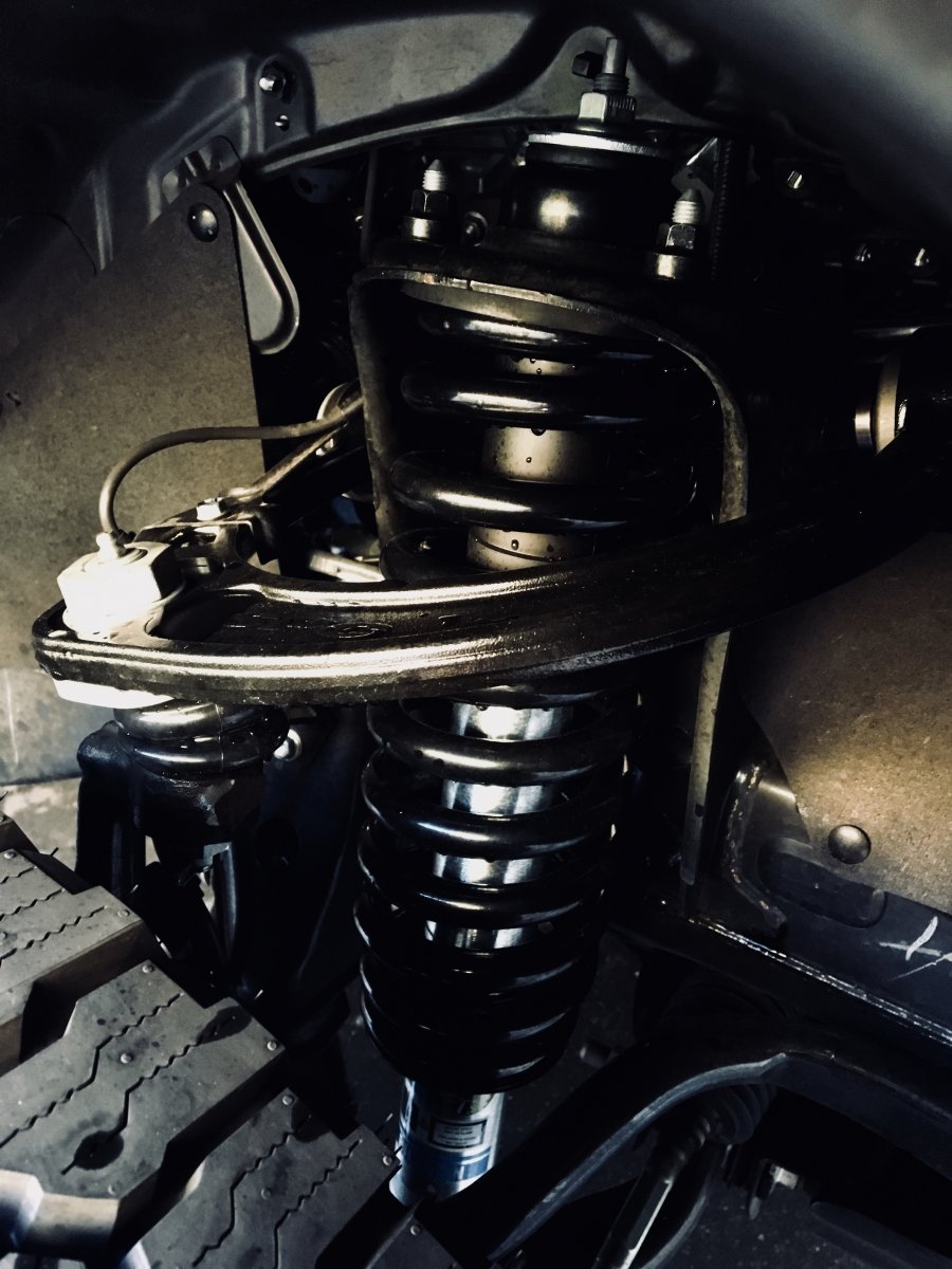

    HeadStrong’s has a Bilstein 5100 lift kit.
    5100s all around set at zero
    OME 887s
    Light racing UCAs
    Dakar’s in rear
    1/4” spacer for lean
    Stealth custom series SR8s 16x8
    Fallen wildpeak AT3W 285/75/16
    Got about 2.75” of lift and kept near stock rake which I like.

  13. Oh and the lift kit cost 1500

  17. Thanks an I forgot to add that my wheels are -12 offset. Minor rubbing halfway to full lock. It’s this small part of the front well that sticks out. Little heat gun and that is fixed. Full lock didn’t run at all.
