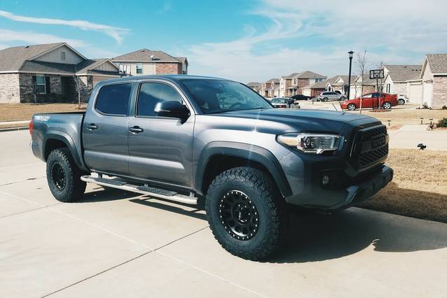

    Found the rims I wanted and 265/75r/16 tires on stock height. I think it’ll be ok.

  16. OR17TRD
    You’ll be fine.

    I’ve seen others bump to 285, but you’ll have to heat gun the front plastic and possibly grind the metal on the back of he wells. It gets a little sketch. Haven’t tried it myself, just watch a guy on YouTube do it. Good luck
  18. OR17TRD
    285/75/16 will not fit without a lift and aftermarket wheels or wheel spacers. If you can not lift the 2018 because of TSS-P at this point the larger tire you can run is 265/75/16. Please don’t try and stuff 285/75/16 on a new stock Tacoma. Don’t hack up your new truck.
