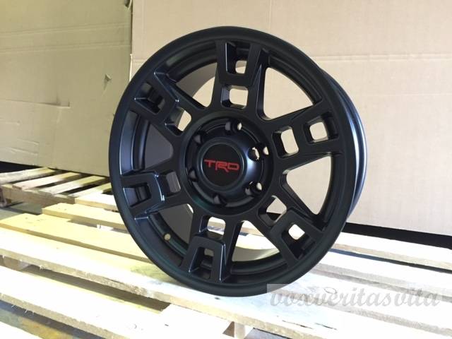

I am looking to upgrade wheels to 17" TRD wheels
My first question is will these work on 2018 Tacoma SR 4x2?
2nd. What size tires can I run with no lift/spacers?

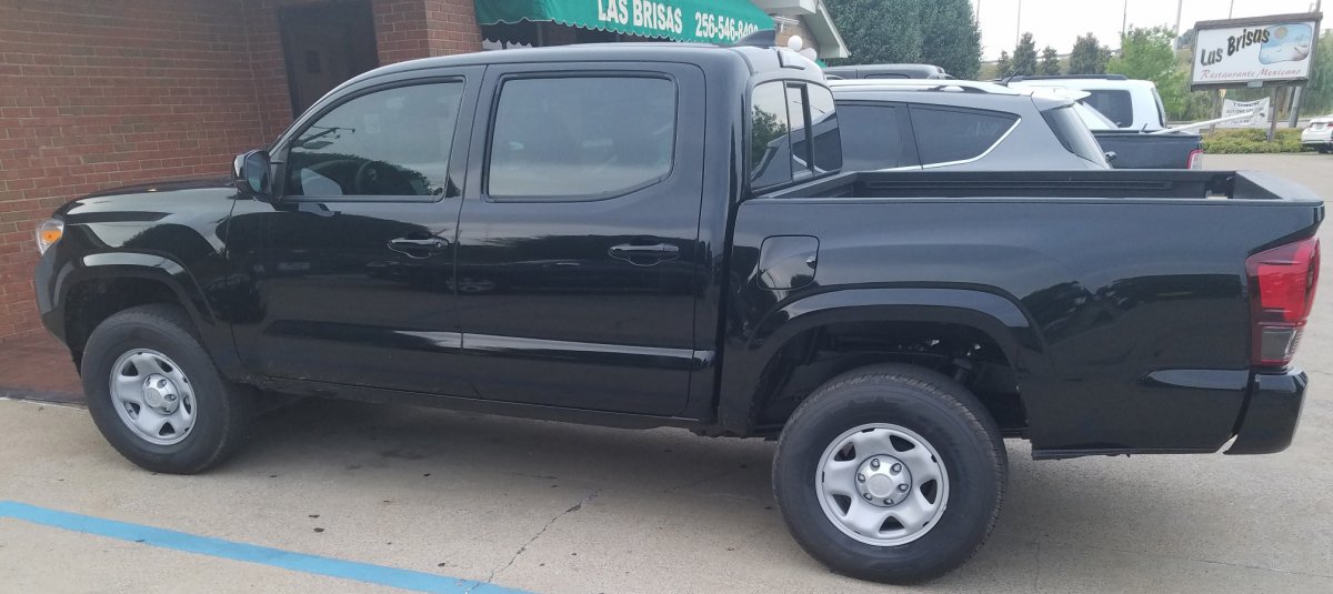

Welcome to the forum. Do you have pictures of it and what is the stock tire size on it?
Thanks!
I would really like to get these 17" TRD wheels. I am not going to upgrade/lift suspension.
Can I run these wheels with a 265/70/17 tire? Also it seems there are multiple size/specs in these wheels. Do you know which I would need?
Thanks for any help you can offer.
The offset on the pro wheels is +14 and the 265/70/17 will be ok with them. You don’t have mud flaps so you should be good. They will look nice on it. What tires are you going with?
