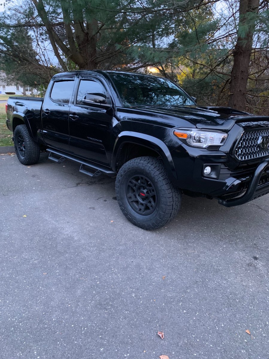

Try a 2” lift with Bilstein 5100’s all around and 2887 OME coils. Just enough of a lift to throw on 285’s! I think you’ll be happy. I sure am...IMG_1573879704.796791.jpg
Will this fit 33” without rubbing?
285s are roughly 33s. It all depends on the offset as to whether it will rub much. Mine had -12 offset and rubbed in full lock going through a dip or incline. And mine had a 3” lift.
