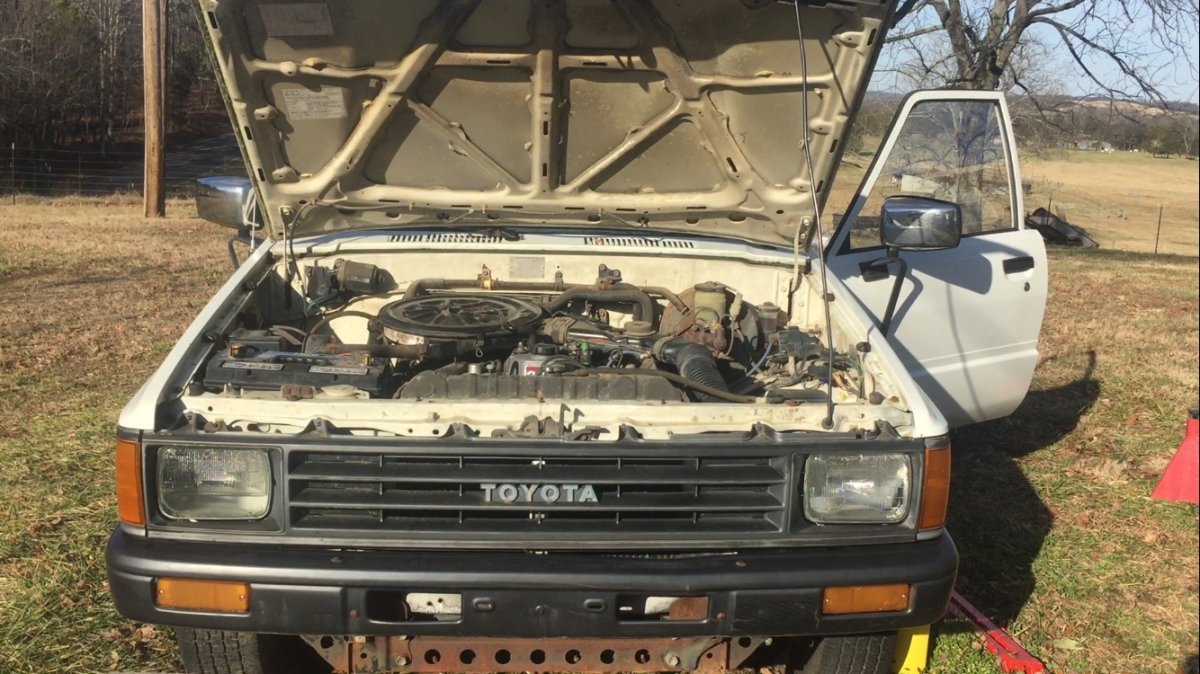

    I am trying to add a picture not sure if it will work its the first time I've used this forum. If it does come through it was from yesterday.
    Bogunn and OR17TRD like this.

    We went through and changed the plugs because at least one wasn't sparking but its a good project truck!
  18. OR17TRD
    Yep that’s a 22r :)
    Bogunn likes this.
