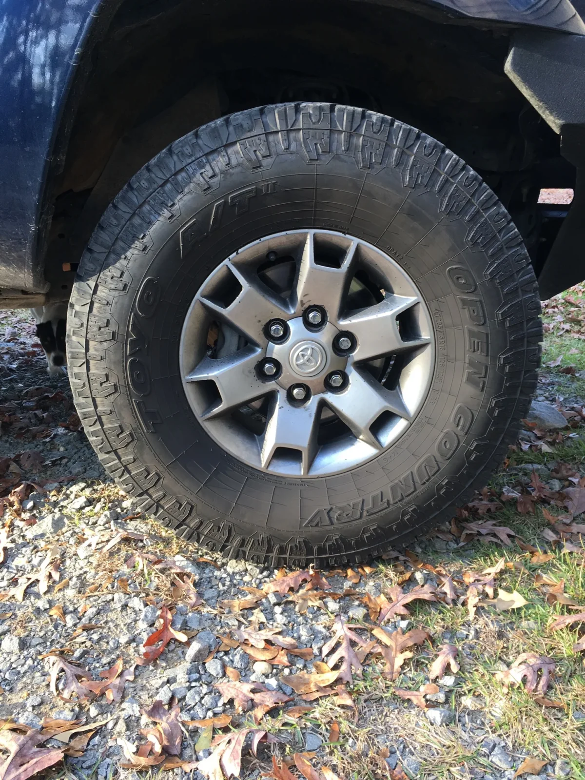

  17. 05taco
    05taco New Member
    Yes you will I have the same exact set up just diff tires
  18. 05taco
    05taco New Member
    Bogunn likes this.
