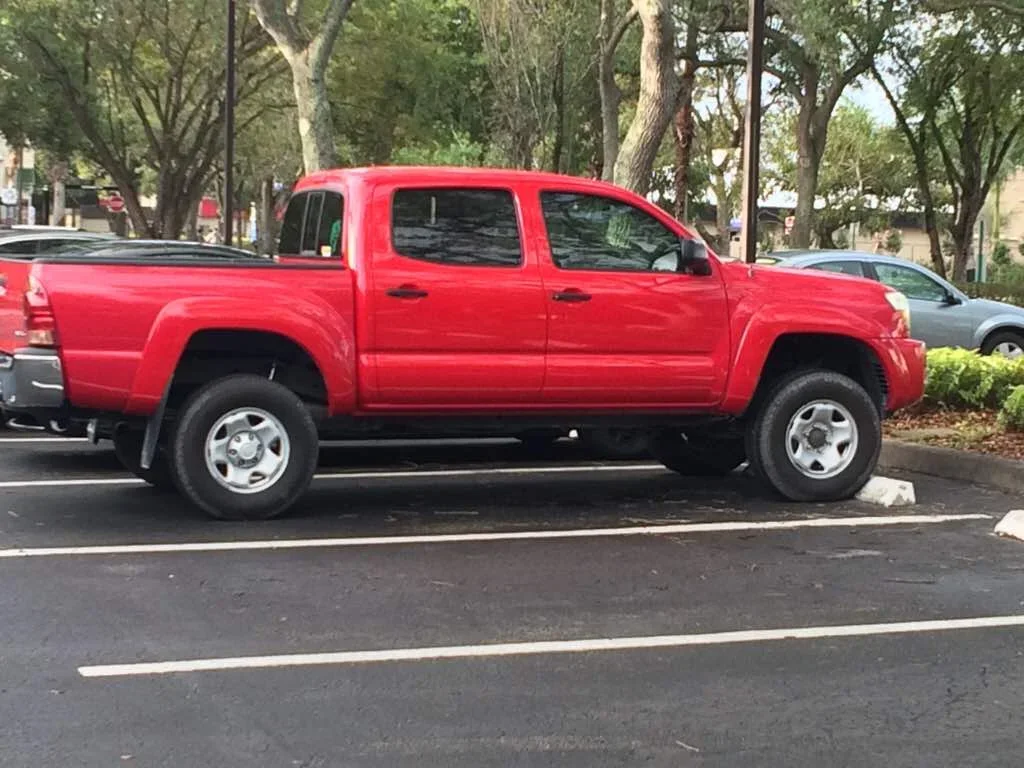

I'm looking into getting a 3" lift for my 2005 pre runner TRD sport. Anybody have any suggestions on a good lift for a decent price? I can't just go out and spend a grand on a lift.
I see a lot of people on here do the Bilstein 5100 adjustable front struts ($200). And then either a 1" block ($50?) or an add-a-leaf ($100?) in the rear.

People will burn me at the stake for saying this but im running the rough country 3 in spacer lift for 250$ and its not near as bad as people make it out to be the only issue ive seen so far is its stiff as a bitch up front like ridiculously stiff lol but for the money its good and you can upgrade to blistens as you get the money

I run a spacer lift too
I'm satisfied with my spacer lift for now, but I'm planning on upgrading once my current setup starts to show any significant wear in the future.

I got the rough country 3 in and 2 in rear and I can't complain it's worked fine for me. But it's only been on for about 1000 miles.
