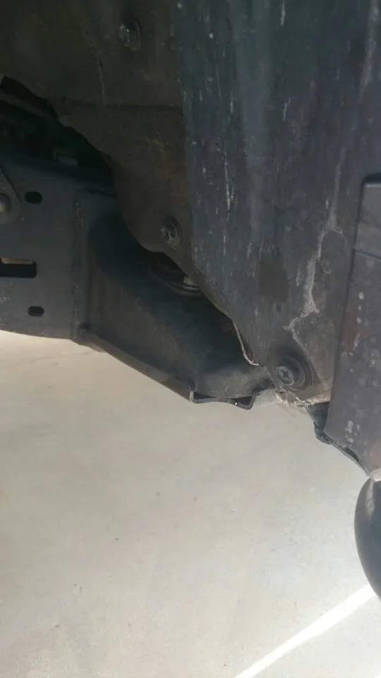

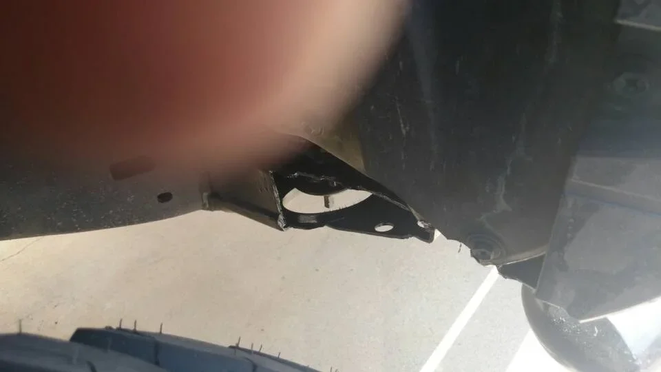

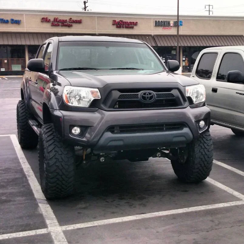

Got my tires on. Had some serious rubbing, but decided I liked how it looked with the wheel spacers, so I started cutting away. Cab mount chop, and some serious trimming of rear part of fender, but I'm good now. Here's some pictures

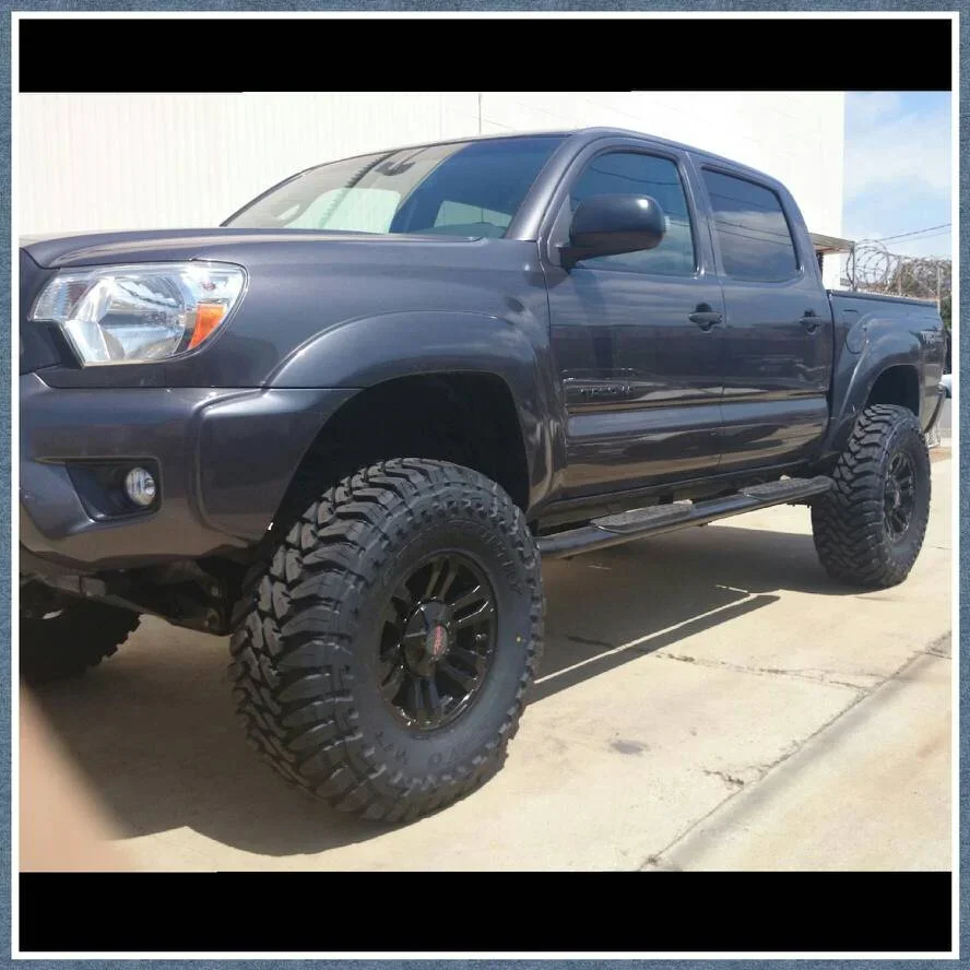

Yeah, I think the wheel spacers threw everything off. Didn't try it without them. Was gonna try, but was having a hard time getting them off,and I said **** it, I like how it looks with them lol. Here's a picture
