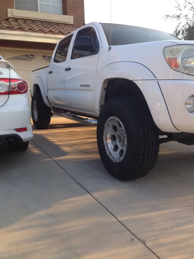

I have 06 tacoma pre runner 2WD and have 16/8 rims with 245/75/16 tires. Tomorrow I am getting a 2.5" level kit installed and adding a 1 1/4
Spacer on the front wheels and 1"spacer on the rear wheels to give it a better look. What size tires should I go with? Or should I stay with my stock tire size.

Yes for the look, but I was told if I do that I might not be able to go with a bigger tire is this true?

I am going forward with a coil over 2.5" level lift and 265/75/16. I am taking your word that it will be fine lol or to play it safe go with 265/70/16?
Coil over lift is a much better choice. 75's will be fine. 70 series are going to look a little small with a lift.

Got it done, 2.5" coil over level lift with 16/8 pro comp rims with 265/75/16 Firestone Destination A/T, feels and looks great, thanks every1 for helping me out. ImageUploadedByTaco Forum1407728568.596176.jpg
