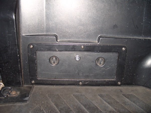

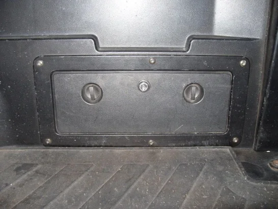

I got tired of the door on my in bed cubbies coming off while offroading so I put some lock on them
You can find these locks at Lowes or Homedepot. All you need to do is unscrew the tabbed stock nobs and drill out the hole a little and bammmmm locking inbed cubby doors!!
I did mine just a tad different a few weeks ago, 2 locks 1 key. Went to Home Depot and got the cam locks and made sure they had matching key numbers. I had thought to do all four but was hard to find 2 with matching key numbers. Didn't feel like paying a locksmith to match 2 more locks to 1 key.
Nicely done! How easy was the installation? Did the lock come with a rubber grommet or o-ring to seal the hole?

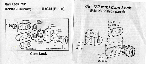

Installation was quite easy 1st I took out boxes with I believe a T6 hex bit and brought them inside to drill out the hole for the lock. I started with a 1/4" Spade Bit & worked up to a 3/4" one and then lightly filed away remaining plastic for a snug fit. Installing the lock I used the 1-1/4" straight cam which was all the length I needed. Then on the box I marked where the cam hit the inside and drilled a hole big enough to fit my jigsaw blade in. Using the jigsaw I made the slot for the cam. Then reinstalled boxes and was done.
There was no rubber grommet or o-ring just a steel trim collar on the outside. I included pics of what I bought and the construction of the cam lock. Cost was I believe $4.95 a lock at Home Depot and on the back of the package was a Key # which I matched to another cam lock so I only had to use 1 key for either lock. Since the boxes had rain holes drilled in the bottom of them I saw no point in sealing the cam lock with a rubber grommet. Using WD-40 or PB blaster periodically on the locks will keep them from rusting up and free during winter.
Those doors aren't that strong and anyone could take a crowbar and break them but it will keep most people from looking in them out of curiosity. I don't keep anything worth value in them as it is (bungee cords). I took my hold downs from the top rails and put them under the back seat storage so they wouldn't walk away and I can use them when needed. Bungee cords I can replace fairly cheap those top rail hold downs cost a little more to replace.
