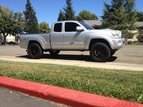

It is now that time to replace my suspension on my 2005 access cab taco.
I have a leveling kit on the front and 32" Nitto Terra Grappler All Terrains.
I want to buy either King or Fox suspension for the front and back.
Does anyone have this suspension on their truck?
I bought Fox extended travel 2.5s for the front and 2.0s for the rear. I haven't installed it yet though. Really both King and Fox make a good product. Fox uses steel bodies while King uses aluminum so take that into consideration when buying. Also look at Icon. Icon uses digressive valving instead of progressive like King or Fox. Just choose a color.
Well let me know when you install them. And what it does to the actual ride of the truck on and off road and what it does to the ride height of the truck.
Ride height depends on what you preload the front coilovers to and what rear lift you have. The rear shocks do not provide lift.
I'm hoping the ride is close to stock.
Do yourself a favor and by them pre owned unless u just want them new. U will save yourself a lot of money. The shocks you are looking at r all rebuildable. All that were mentioned pretty much work the same and will give u a great ride. Good luck.
