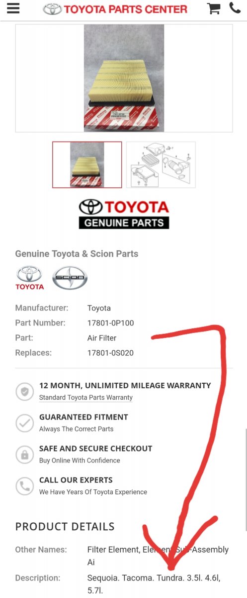

OEM, do you have any signs of it not flowing enough air?Looking to make an upgrade to air filter on my SR5 ‘16 Tacoma. What is recommended and why?
