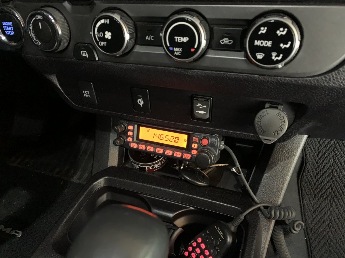

What kind of radio are you installing or have you made it that far yet? I have a yaesu 7900 with a separation kit. The radio is under the passenger seat and the face is at the wireless charging pad. I also installed an MFJ external speaker facing the driver seat but behind the panel under the steering wheel.

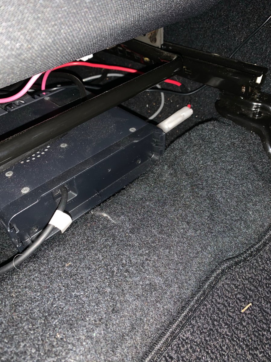

There is a rubber grommet on the passenger side if you peel the carpet back that you can poke a small hole through to run positive and negative ground. If you’re wanting to do the separation kit, it will be a much cleaner and easier install. There is a slit in the carpet under the seat that I brought the power and antenna wire through. I will try to get some pics shortly of everything. I put some double sided 3M foam tape on top of the face that sticks to the top part of the cubby hole where the charging pad is.

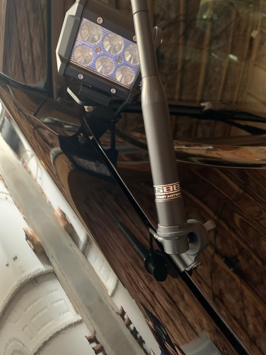

Hope this helps, Mike. I also included a pic of the comet 2m/70cm antenna with the hinge mount. Great antenna and it doesn’t look tacky in my opinion. 73!
The pictures are really helpful. Is the antenna lip mount on the hood? I was thinking of a mag mount on the rood.

Yes it’s lip mounted on the hood. It allows pivot left to right as well as front to back so it can be mounted on a horizontal or vertical lip while maintaining a vertical antenna.

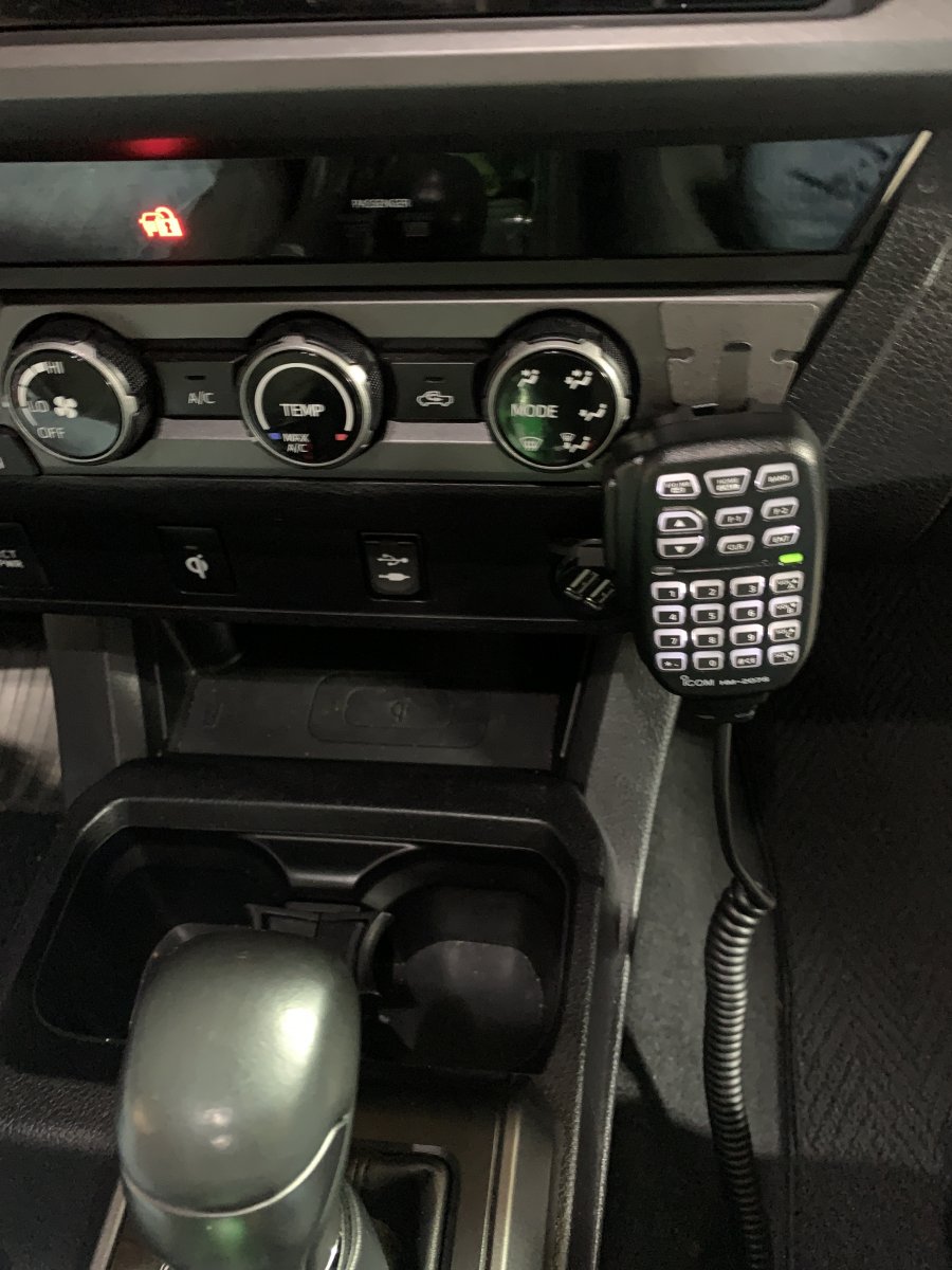

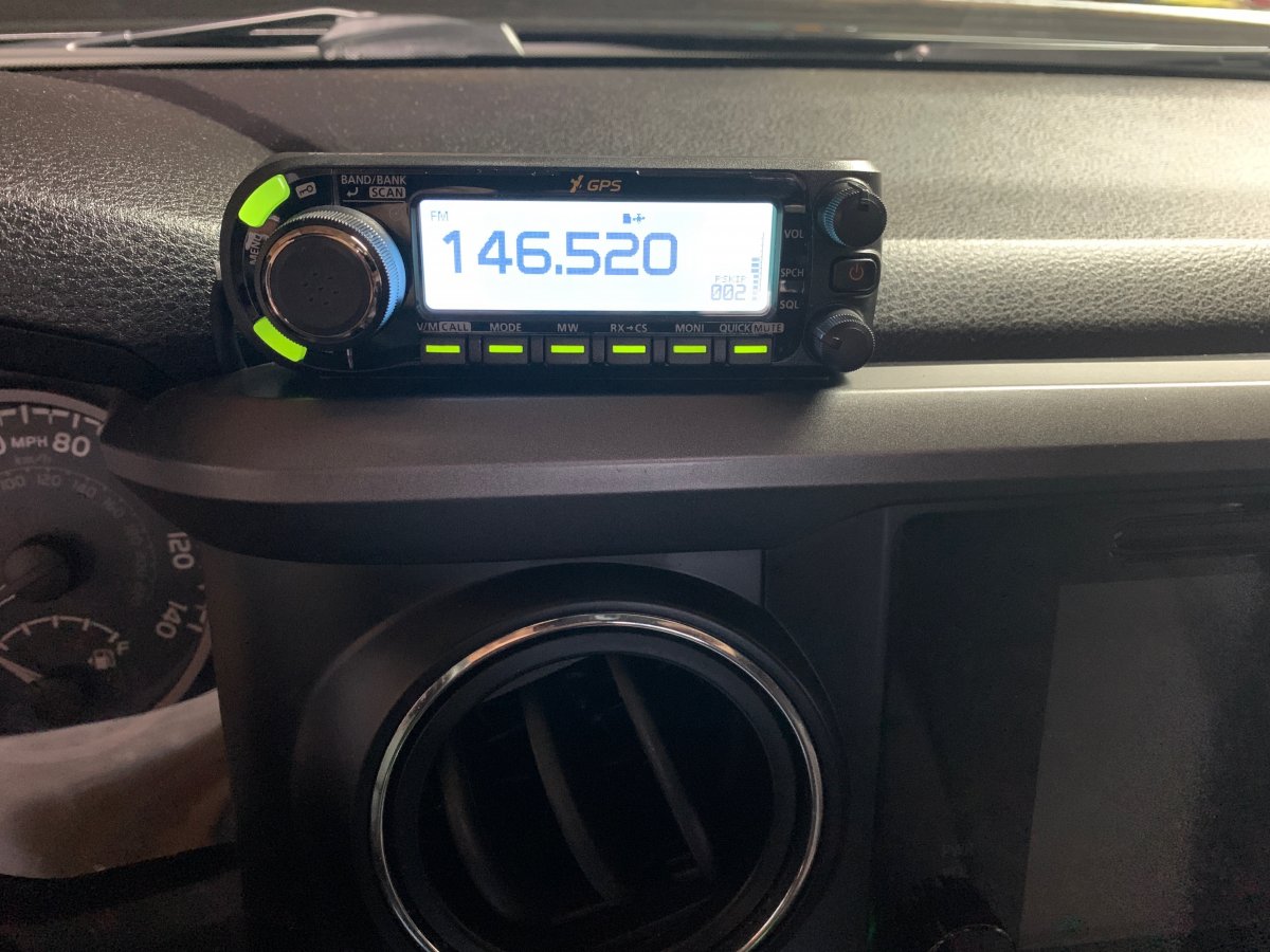

I pulled out the 7900 today and swapped it with an Icom 4100. Put the face on the top of the dash so the gps would lock good. Seems like a good little rig.
The radio was a complete unplug and plug into the wiring under the seat I had from the yaesu aside from the separation cable which the 4100 came with.
I like the install, I like it on top of the dash verses below. How did you attach the radio head to the hash?

Mike, it is D-Star and I used the same 3M double sided adhesive foam like tape that I used for the yaesu unit I had. That stuff is super sticky and very thin but with a little force you can get it unstuck and it not leave behind any goo. No more than those little faceplates weigh it really works well. The only reason I didn’t like the yaesu on the dash was because the mic plugged into it vs the Icom which plugs into the radio itself that’s under the seat. I still need to get the 8ft mic extension but it works for now
