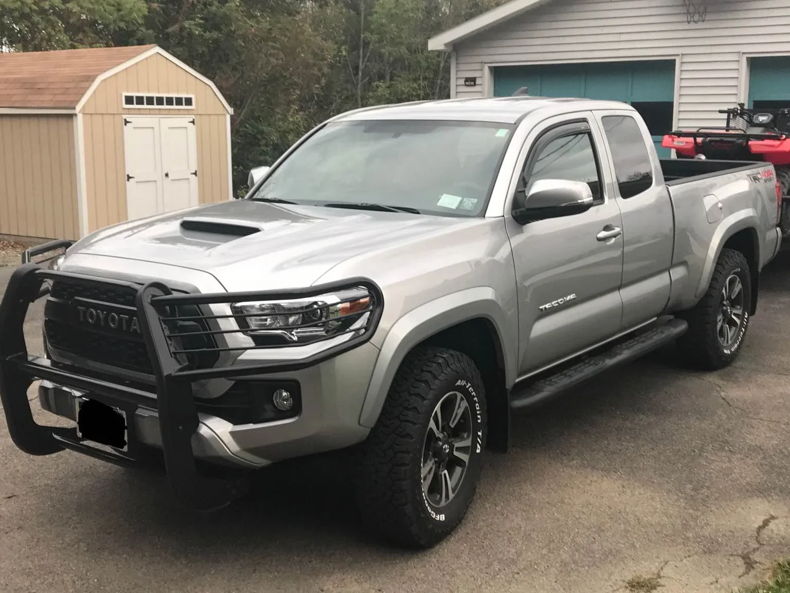

    I hope you have a speedy recovery! Here's a pic of my new '17 to pass the time IMG_1446.jpg
