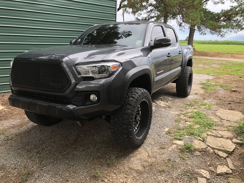

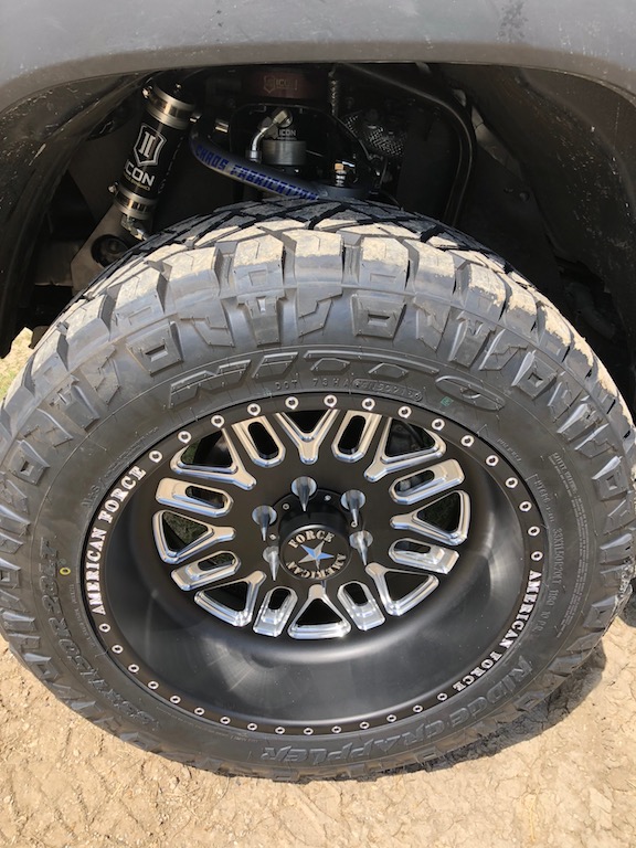

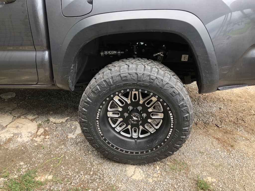

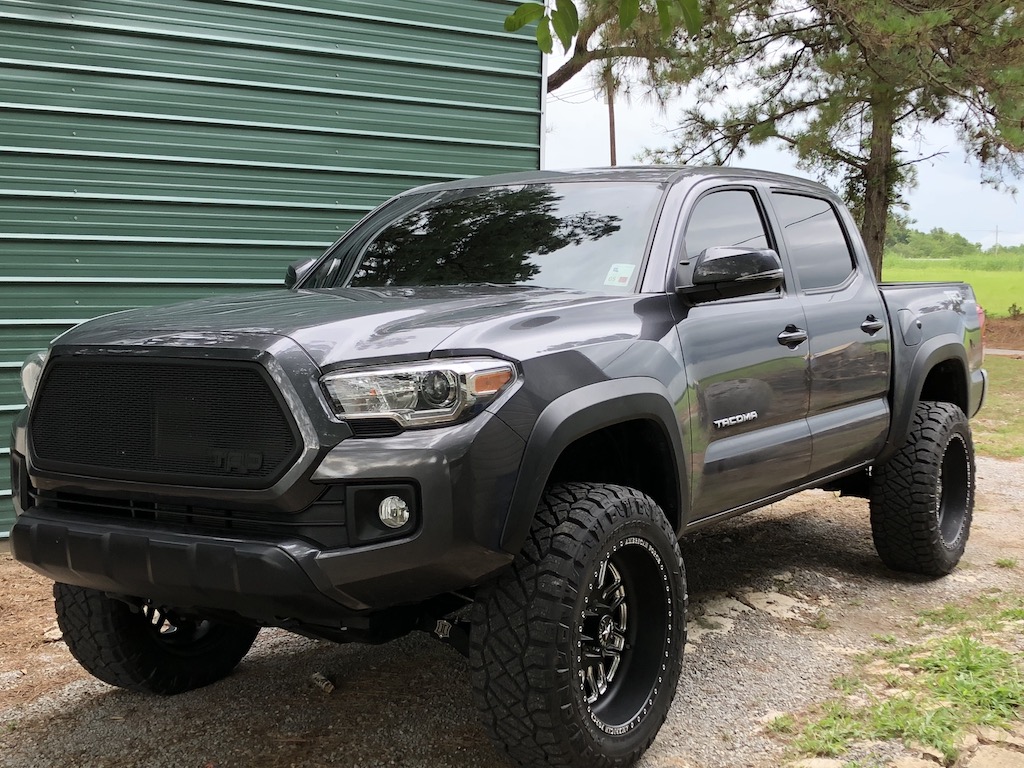

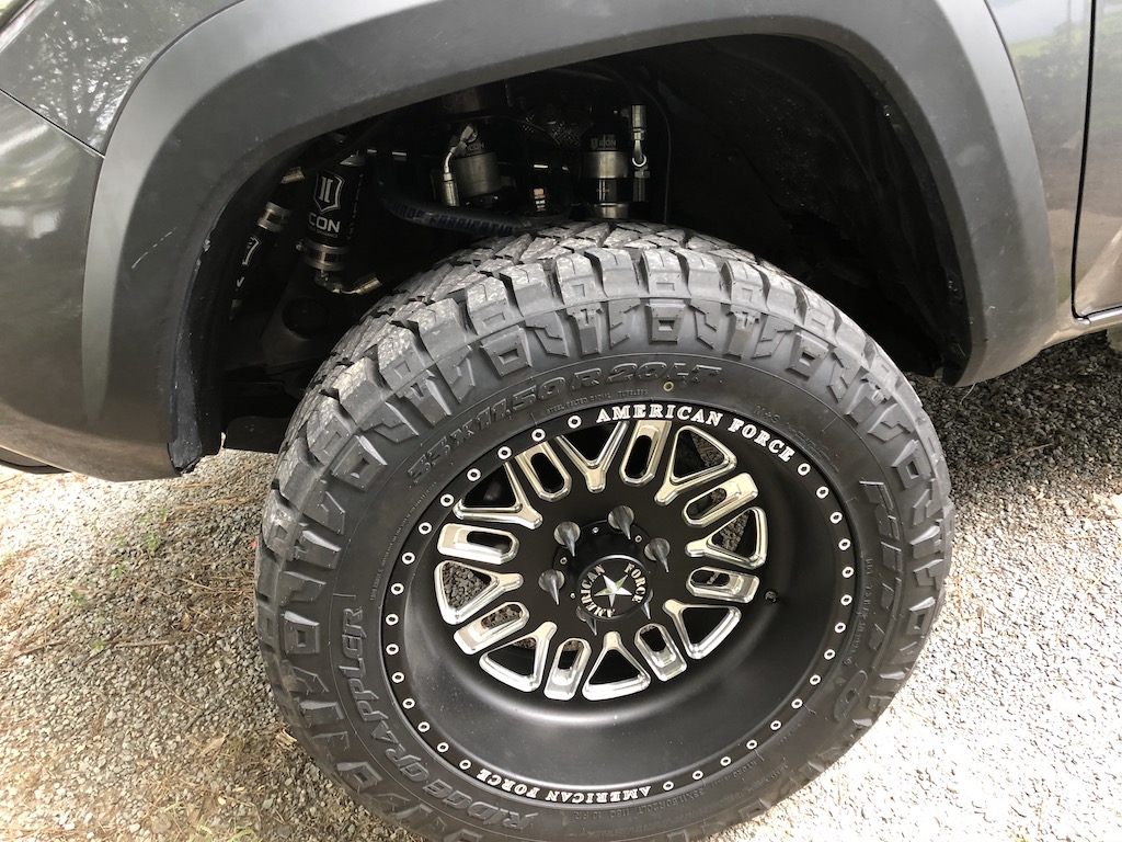

    So I ended up going with a kit put together from Headstrong Off-Road. Their was a lot of back and forth discussions about what items would best suit me for my end goals. Very knowledgeable people and great to deal with. It took me a while to get everything together and have it put on between me working out the country but I managed to have it all on the day before I left out again.
    • Front - ICON 2.5 coil over / extended travel (Progressive Valve) reservoir shocks (higher spring load rating front)+Stage 2 secondary adjustable damping shock / Rear ICON 2.0 VS reservoir shocks
    • Icon hydraulic bump stock, skid plates
    • ARB Dakar OME Full leaf pack replacement / U-bolts, D-shaft spacer, shackle kit, bushing kit
    • Total Chaos – Heim Joint Pivot UCA’s / P# 96504-H
    Wheels/Tires:
    • 20 x 10” -25mm offset, American Force / Special Forces Sires - RUCKUS SF8
    • 33” x 11.50 R20LT / Nitto Ridge Grappler
    Truck rides great and I can't say I notice any power loss from the tires. I did have to do some trimming to allow for the wheels to clear but the installer did a real clean job and it's not noticeable. I also put in a pull-glide retractable bed slide and a Low-Pro color match aluminum bed cover. I wanted to turn the entire bed into a toolbox.
