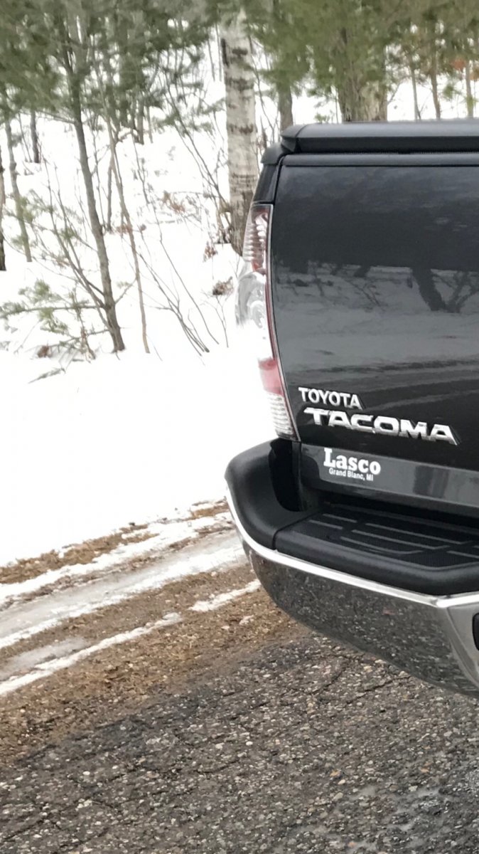

Guys, aside from the obvious- just taking my time and proceeding carefully, does anyone know of a tried and true way to remove a dealership decal without harming the paint? Is there a special solvent or compound I can purchase and apply beforehand that will facilitate removing the sticker, but not the clear coat paint?IMG_1576509177.538564.jpg
Don't you hate these decals... free advertising for the dealership and they just look ****ty. Always remove mine too. a little heat... peel slowly... clean up any glue residue with rubbing alcohol, goo be gone - only the mild gel version or even straight gasoline on a rag and then cleaned with window cleaner or soapy water. Never had a paint problem with this approach.
