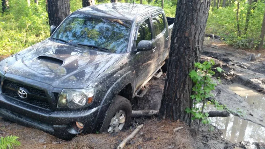

This is my truck on a recent trip.needing a lift.lol
Nice looking truck, I was so stuck between getting silver, black and white. Went with the black and love it but have seen some very nice silver and white ones

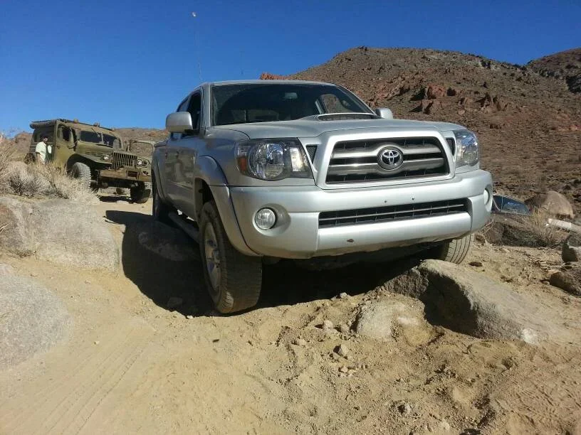

2011 trd sport dcsb 4wd.

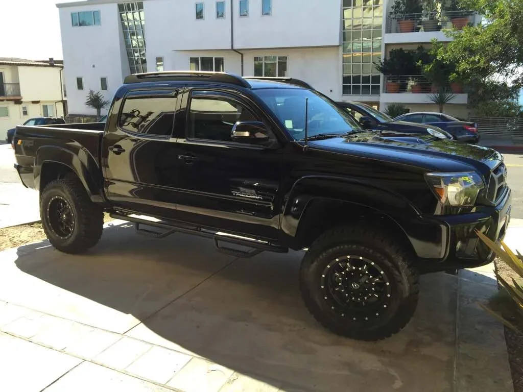

I have a 2.5 leveling kit on mine. I run LT265/70/17 and it only rubs in full lock when I turn.
Wow that's nice.what leveling kit do you have.thats the color I really wanted but couldn't find.
@sfstud nice wheels. I'm thinking of picking up the black semas. How do you like it on your tacoma? Is the rubbing bad?
Being that they are OEM fitment, they ride great. Even when in full lock, they don't rib that bad. I have no damage from the tires.

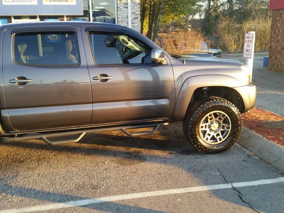

I recently went up 2.5 with some billies 5100s up front with Eibach coils and billies 5125s in the rear with the TSB and. 1.5 AAL. Found a great tire size for them, Cooper Discoverer 275/70r17, kind of an off tire size to find but they look amazing. Had to take the front mud flaps off and take a utility knife to trim a few cm of plastic. Still barely rub if I am at full lock and hit an incline ImageUploadedByTaco Forum1423963219.690273.jpg
