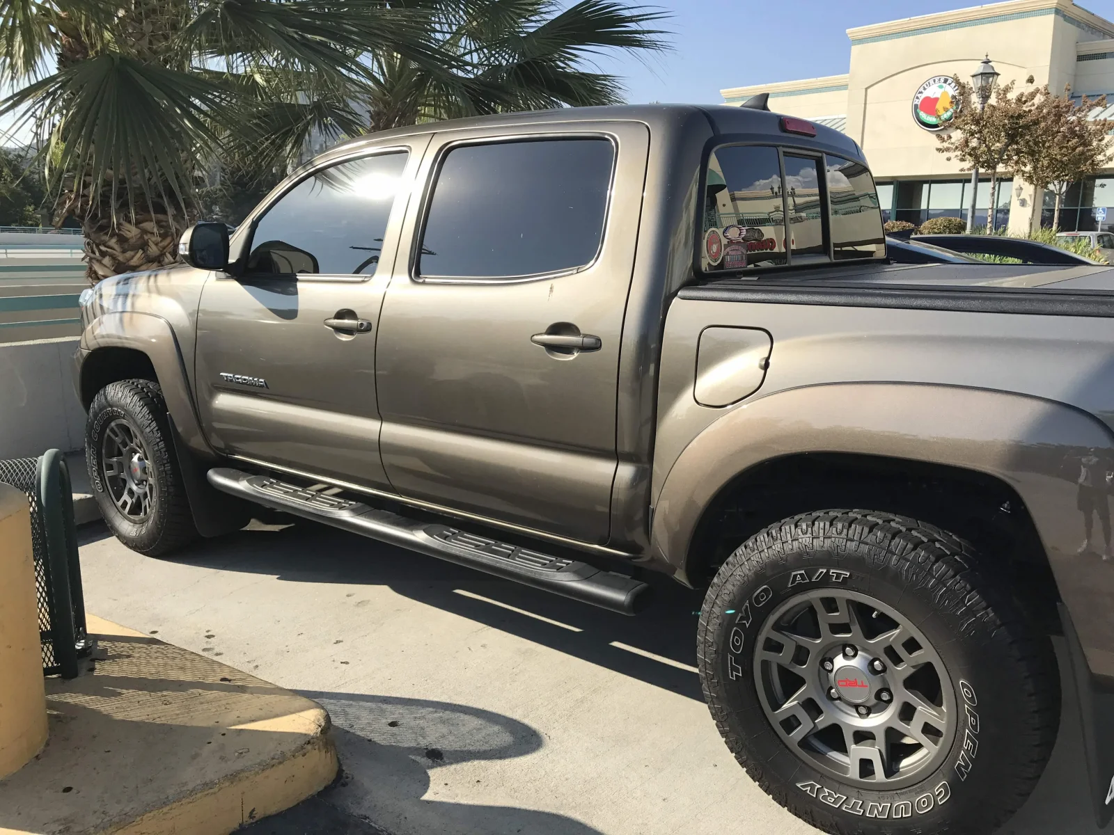

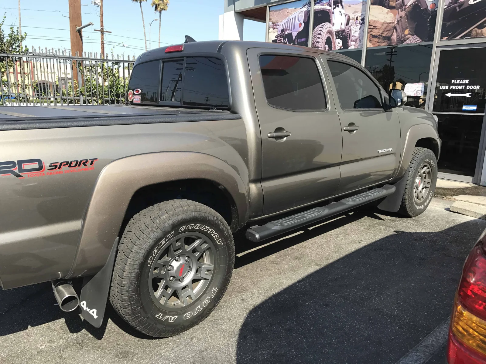

Bilistein 5100 lift
Rear?? Don't know what do you suggest..
I would get Dakars if you can afford them you can take the 3rd leaf out of the pack and it will sit about 2" over stock. That will give a slight rear rack with your 5100's set at 1.75". If you decide to set them at 2.5" you can put the removed leaf back to level it out again. You can also always put it back in later if you get a heavier rear bumper or a cap and need it. Otherwise there are AAL for the rear to bring it level. Toytec or Icon make 1.5-2" AAL that should work for the 1.75" setting.
