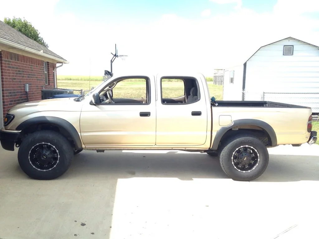

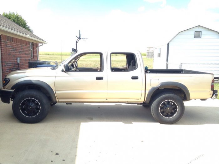

So this is my first tacoma, and my first 4wd. I've driven mostly drag cars and 2wd slammed trucks before I got this baby. It's an 04 ext cab taco and I was wondering if I could possibly just put 3 in blocks in the back and 3 in spacers in front. Would that make the car uneven or would it be level?
Since the rear is already higher than the front if you put 3 in F/R than it'll be the same rake as if it was stock but 3 inches higher, get what I'm saying? But if I were you I would save up for a real lift kit because spacers and blocks are junk.
^^^^Yup. Use OME or Bilstein 5100s and an AAL out back.
Trucks are normally rear end high so adding 3 inches to the front and rear will result in a rear high truck.

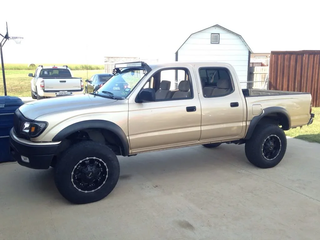

Yes it was worth it. The mounts were $135 and I just had to buy the self tapping screws. The bar I got from apexleds.com and it's the AS series 40 inch. It was pretty simple if you know basic wiring
