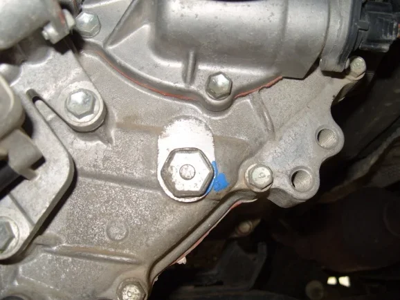

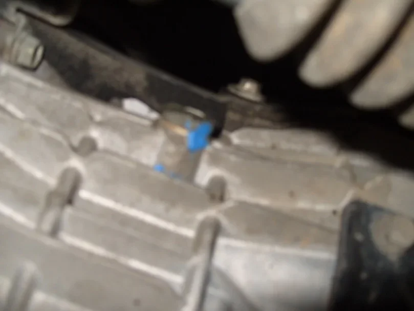

Curious as to what this stuff is. It's on my fill plugs, manual transmission, rear differential and transfer case. Don't see it on the front differential. Is it something they put on during factory build? Getting ready to change all gear fluids, truck has 50k on it. If it's something they put on during the factory build then it tells me none of the gear oil has been changed. Pics enclosed are transmission & transfer case.

That's what I thought. So I'm right to assume none of it's been changed. Well, it's getting changed now.
Yeah never touched. 50K isn't late or anything. Maybe a little late if you have a rear LSD (05-09 Sports and some SR5s).
I usually do my diff fluids and transfer case every 30K miles.
I've changed my front diff when I put the ecgs bushing in but I am getting close so I'm gonna swap them all over to amsoil
3.73 gear with LSD '06 SR5 has the sticker. Rearend is quiet though. I bought it at 47k in Jan this year.
