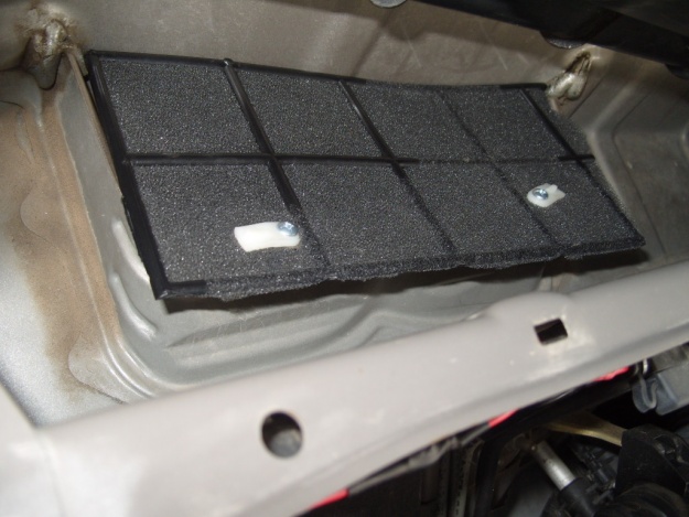

I'm still on the original...cleaned it a few times over the years though. To keep the critters and stuff out i installed mesh over the opening (under the windshield cowling) and put a thin layer of furnace filter material over it...

That's not a bad idea, since a cabin filter runs about $20 a pop. Need to take a trip to the hardware store and get me some screen and then get one of these filters. Cut the filter to size, discard the frame and never have to buy another $20 in cab filter. Just wash the other one out every so often. What I don't use, I can when it wears out. I use one for my furnace as it is. Haven't bought a furnace filter in years. Just spray it out with water going opposite of airflow. Great Idea OffroadToy!

This should help make the cabin filter last much longer. Got enough to make 4 more of these. Plus you can wash them. Cost $4.00 at Ace hardware for a section 15 x 24 . It's Plastic Back Foam for window A/C units. Just cut to size.
