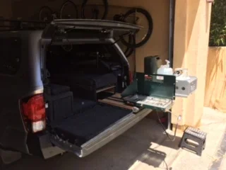

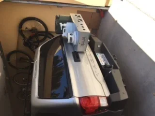

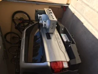

Interior space is a premium for a Tacoma camping configuration. I have had the attached cargo carrier fabricated to carry a 5 gal gas can, 5 gal water can, and 2 lb propane tank. It swings out to accommodate attaching to my coleman stove. It is removable when I don't need it. The carrier is made with the ability to secure the cans when traveling with straps, and a cable lock when security is needed. It is designed not to interfere with the backup camera or mounting a bike rack. Very pleased with this solution
Addendum
The carrier is outfitted with a rear break/turn signal light. The carrier was fabricated by Baja Fabrications, 619-710-2800. Ask for Sam Stahl. Tell him Jack referred him. Quality people and workmanship.

Is that attached to the aftermarket bumper? What bumper?

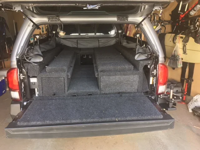

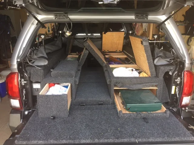

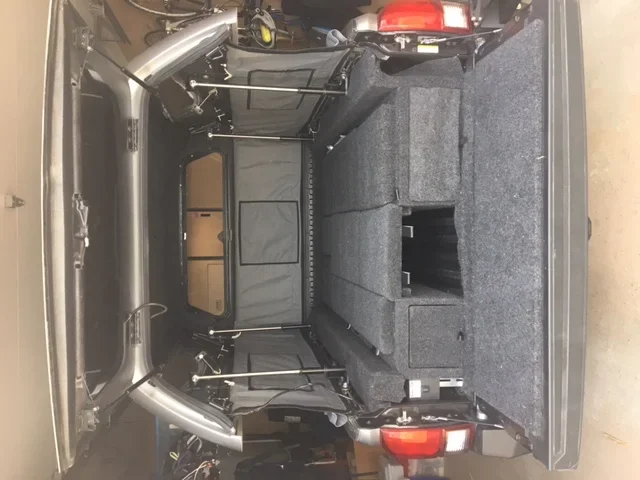

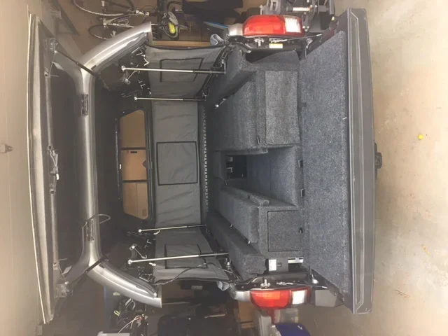

The interior of the cap includes cabinetry. Drawers for coleman stove and for easy access supplies. I had Windoors installed in the Leer Cap for ease of side access to load and unload. The Cap lifts 17 inches for head room. The lift is from Topper EZlift. It is all electric so no hydraulics to worry about. Once lifted, tent canvas with windows and screens is deployed. I did not like the flip top campers. The middle floor panel slides out and rests on runners on the cabinets to make a bed. I have the pictures attached.
The bumper is FabFour. It is very sturdy and good quality.
