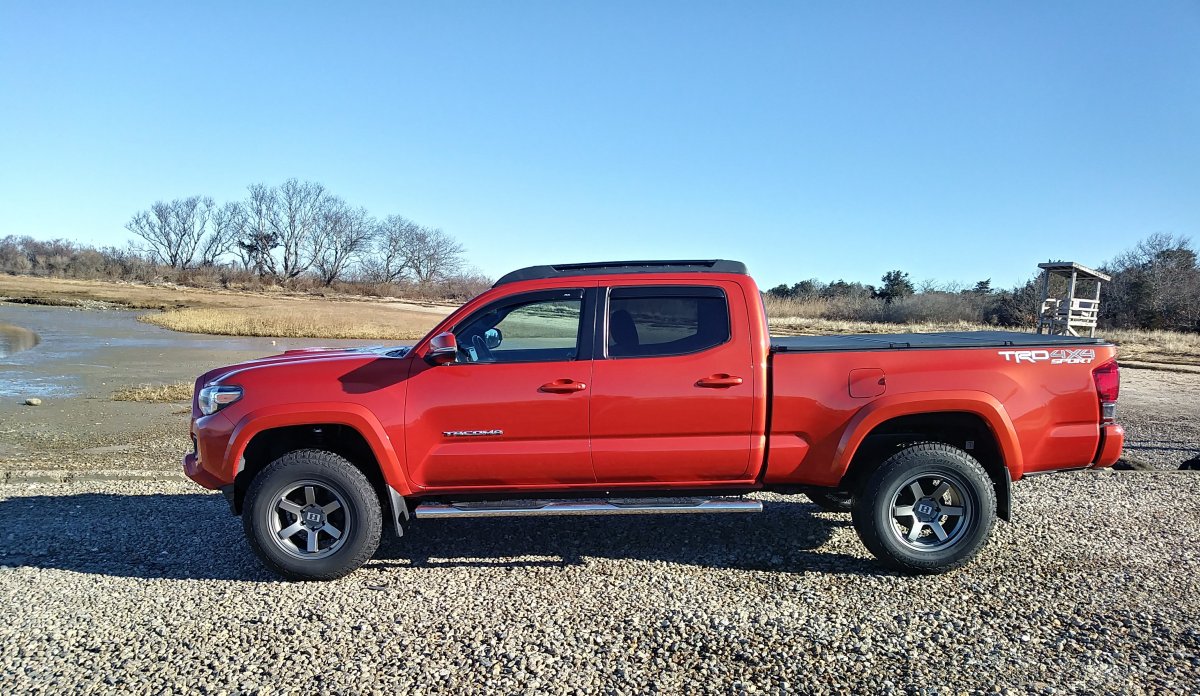

    Dark gray from Level 8 mk6 is the wheel. 17 x9 ,4.5 backspace -12 offset .
    1.5 lift front and back

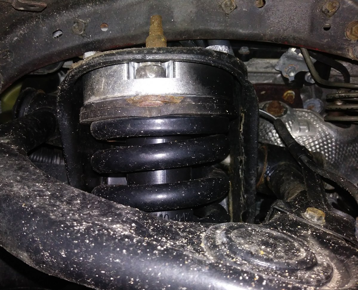

    How'd you get the 1.5 inch lift front and rear?

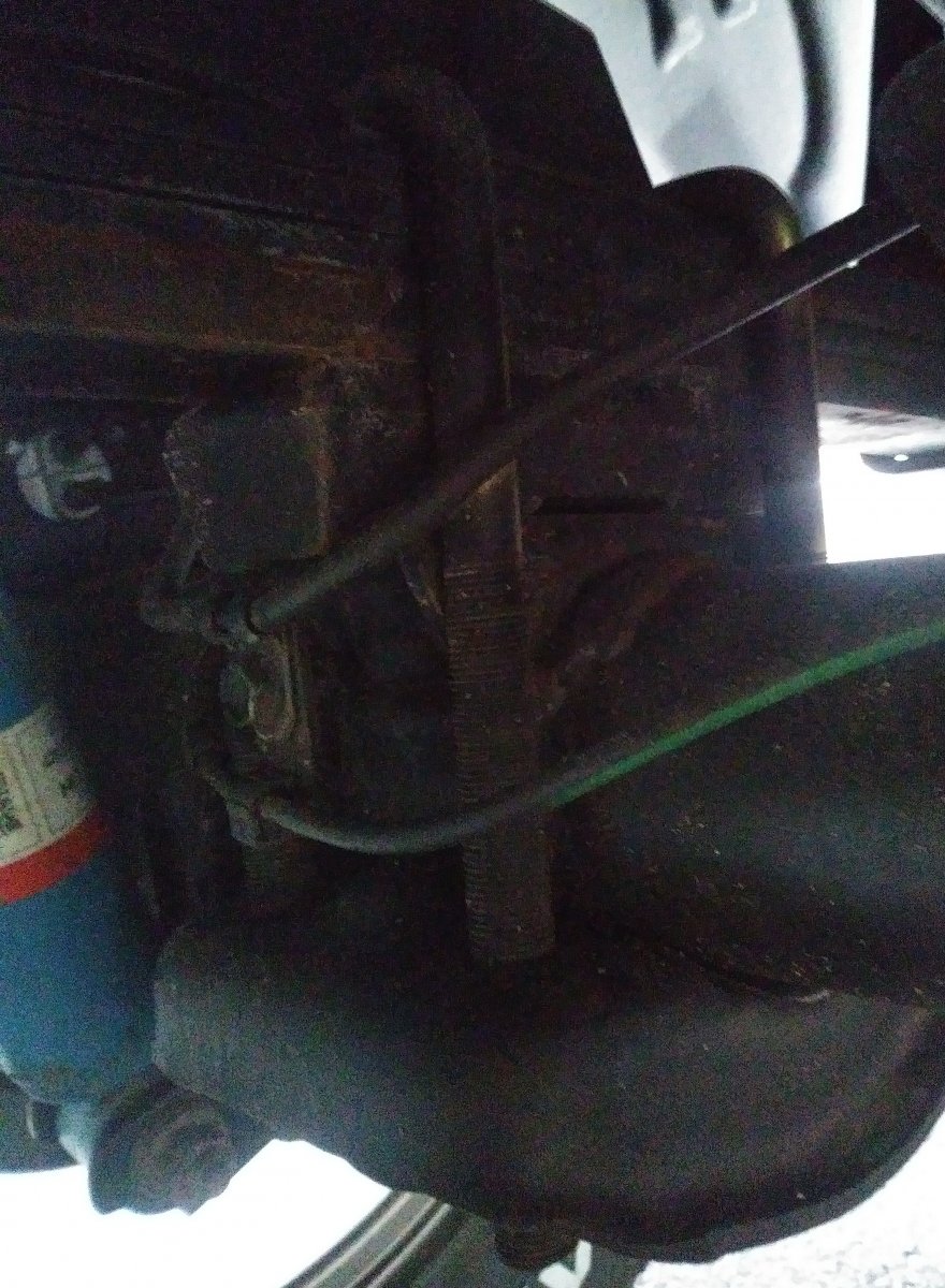

    I used the 3/4 inch front spacer on top of the spring and used a factory GMC spacer block in the rear I got from my friends truck when he put a 4 inch lift in his '15 z71. I'll get you some pics . and drilled the rear end shock plates to use 5/8 U bolts
    Instead of wimpy 1/2 from factory.

  7. Cape taco
    Cape taco Well-Known Member
    For 2018Turd here some pics .the GMC block fit dead nuts on the spring and axle plate it could not have gone any smother .except if some one else did it for me. lol 20190222_065236.jpg 20190222_065206_Burst01.jpg

  8. Scott Wyman
    Scott Wyman Well-Known Member
    Fits like a glove.

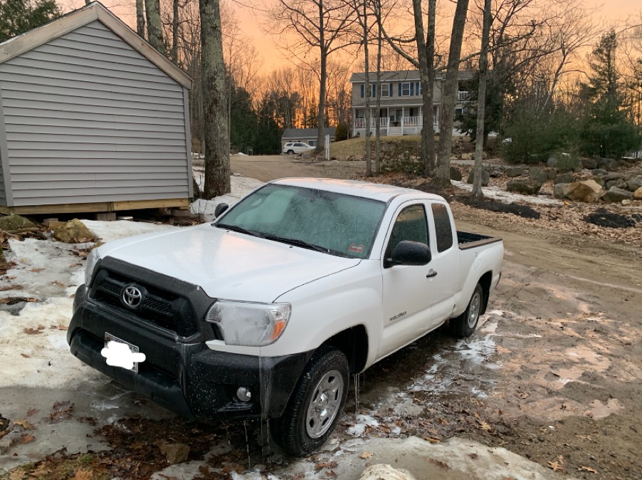

  9. LukesDecals
    LukesDecals Well-Known Member
    Highest quality chrome over here!

  11. Gregory
    Gregory Well-Known Member
    You also have those icicle mud flaps everyone is talking about! Brrrrrrr!!!

  13. LukesDecals
    I do live in the great white north, Maine! however this picture is deceptive, that's just the foamy taco bath dripping down! looks cool lol

  15. 2018TuRD
    2018TuRD Well-Known Member
    Any lead where to find them front spacers if the gmc ones fit?

  18. Cape taco
    I got mine on the EBay . came in a couple days I can find out company when I get home .the front 1.5 inch spacers is 3/4 of an in tall .its not too hard to do just be patient taking out the strut .and removed the top ball joint . just have to jack truck up pretty high .took couple hrs .they are not very expensive like under 50 bucks I believe. I did the poors mans street truck lift its not heavy duty like tacomania'$ .lol I only go 4 wheeling on the beach .:cool:

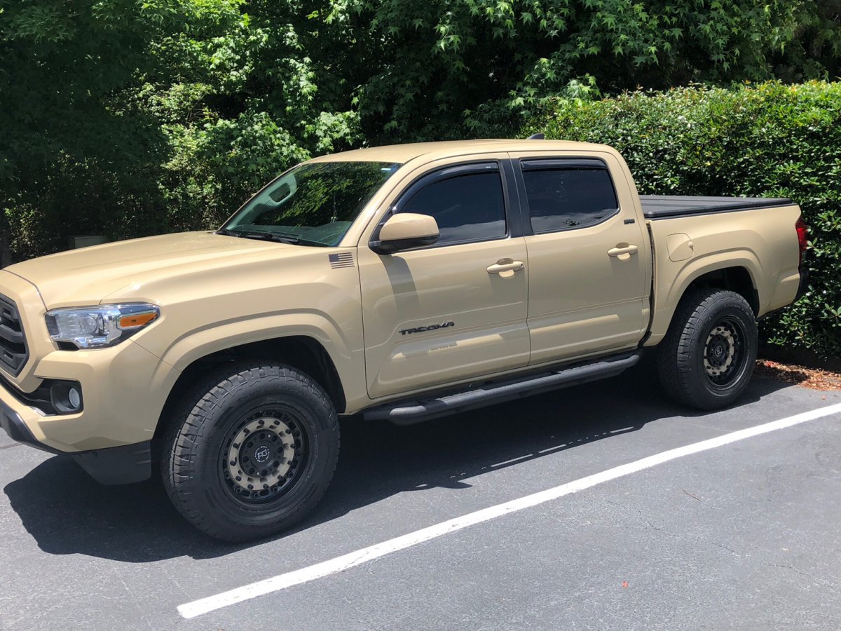

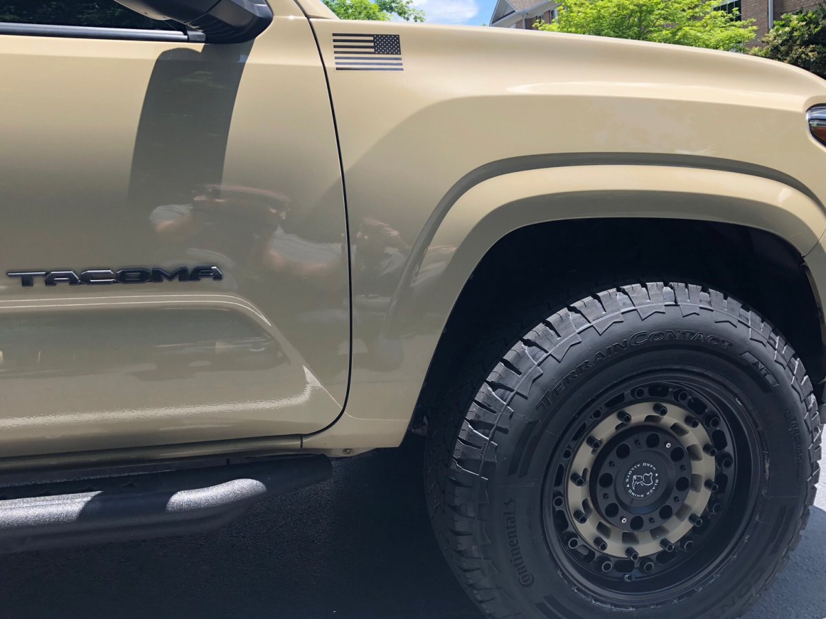

    Newly update wheels and tires with 9mm air valve covers. Wheels are the Black Rhino Arsenal with Connential tires (“17”) IMG_1170.jpg IMG_1554412869.805861.jpg IMG_1554412922.724605.jpg

  20. B-Man
    B-Man Well-Known Member
    Good lookin' Taco right there!
