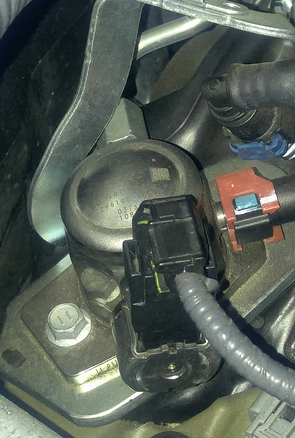

I have a 2016 Toyota Tacoma off road. It has this clicking and chirping noise that is really loud. it started doing this about one month after I purchased the vehicle. I brought it into many different dealerships and every time they tell me Toyota is aware of this but they don't know how to fix the noise. They are awaiting on a fix. has anybody else heard of this or are they just blowing smoke in my face

Been to 3 different dealers. Some tell me immediately without opening the good. The sound is coming from left side of engine when I'm front looking at it. Towards back of engine. I used a mechanics stethoscope and think I isolated it to one devise but don't know the name of it. It has a shiny aluminum round top with very tiny holes on it. Anyways I am being told some tacoma trucks are loader than others. They won't replace part. I never had this sound when I bought truck and if it was there I would not have then.

Can you take a picture of what you think it is?
Thank you. I find it terrible toyota did not find this as a problem. I'm about to have it replaced and if noise goes away in going to raise the dead.. Thanks again
