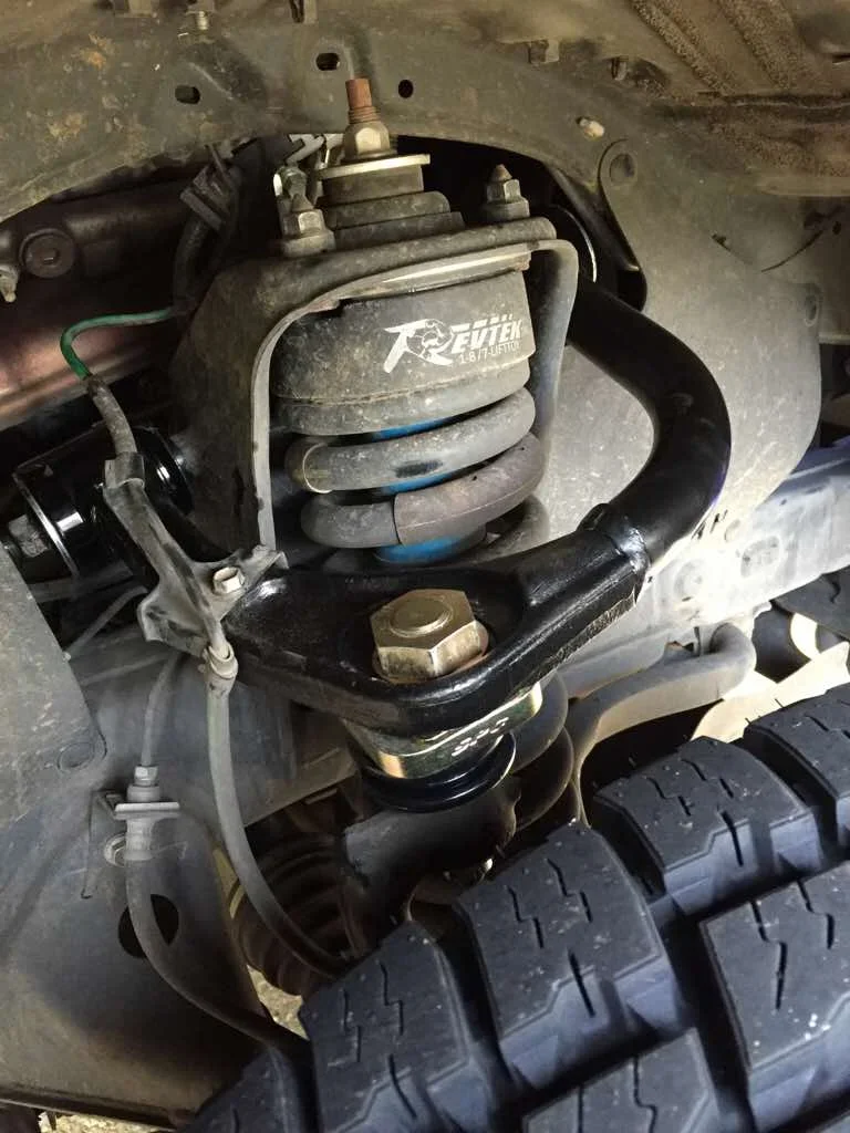

These adjustable SPC Light Racing UCAs are an outstanding choice when upgrading your lift. They are a beefy ball joint design that are on par with or better than a uniball design. They also cost around 50% of what most uniball UCAs are typically pricedImageUploadedByTaco Forum1464492614.406890.jpg

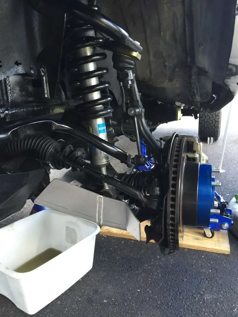

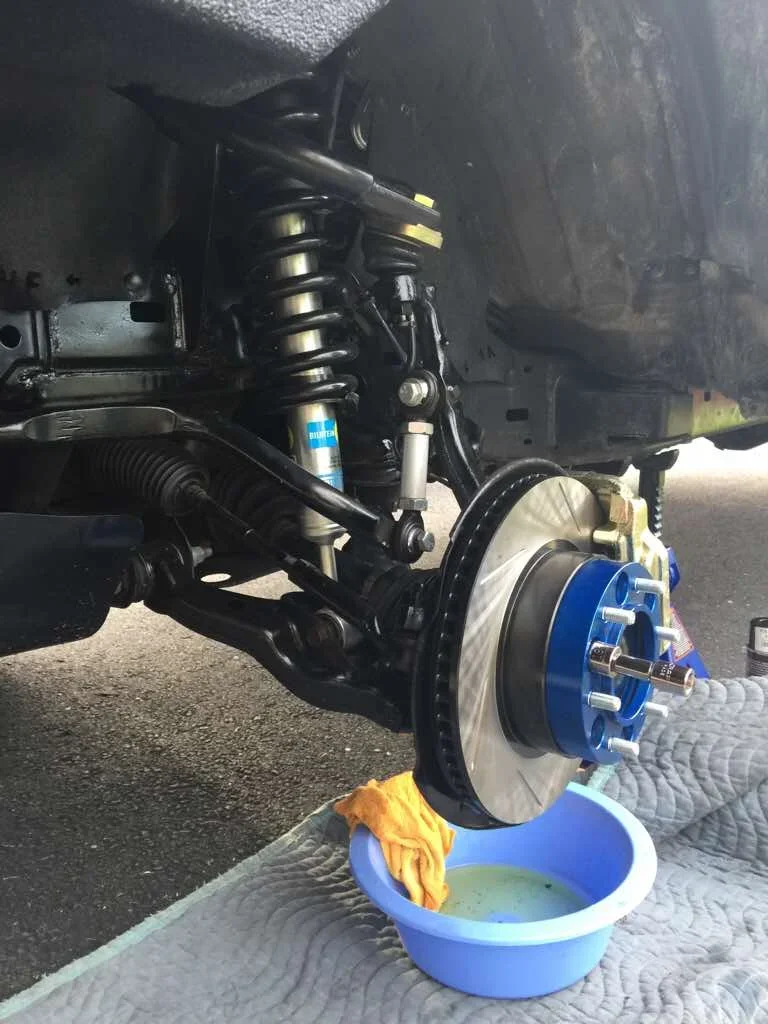

I know it needs to go back to alignment shop but want to know if this is possible before I ask them about itImageUploadedByTaco Forum1469585609.807331.jpgImageUploadedByTaco Forum1469585626.373459.jpg
