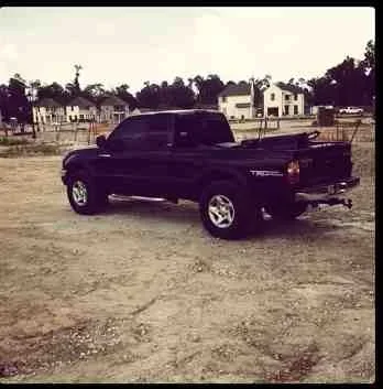

My 04 taco is running great but the fan is blowing extremely loud, especially when I accelerate, it is electric. Do I have any real problems or am I just a hypochondriac lmao!?ImageUploadedByTaco Forum1379350109.229750.jpg
If it is electric it is not stock. If it is working then I would forget about it. If it was the OEM fan then I would say that the fan clutch has locked up and it would need to be changed.
I second what whipper said.
A question though, how warm does your truck run? The needle on the gauge should be right in the middle (or slightly higher, mine sits a bit over halfway up the gauge when hot), if it's in the upper 1/3rd of the gauge then your truck is running warm.
Also, do you still have the stock (motor driven) fan installed?
