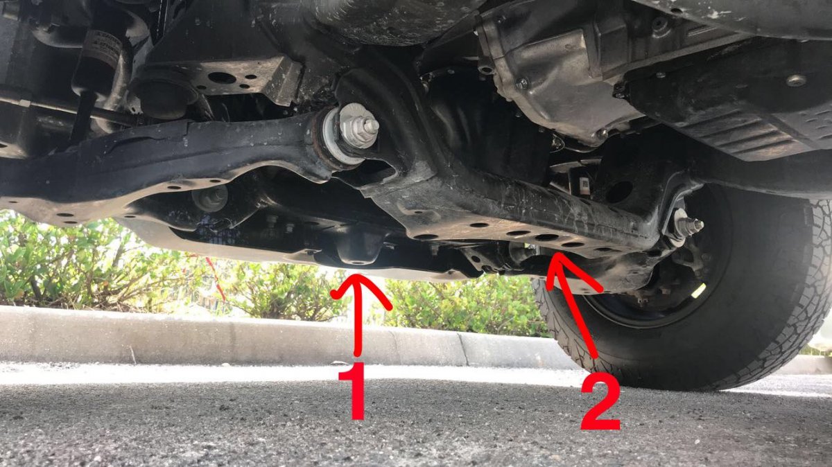

Taco Slinger 4000 Well-Known Member Jun 2, 2018 #1 which one is these spots is an ideal spot for a floor jack saddle? 1 or 2?
Bojangles Well-Known Member Jun 3, 2018 #2 Taco Slinger 4000 said: View attachment 18409 which one is these spots is an ideal spot for a floor jack saddle? 1 or 2? Click to expand... Manual doesnt have a diagram? 2nd gens use the hump
AZ Pete Well-Known Member Jun 3, 2018 #4 Taco Slinger 4000 said: View attachment 18409 which one is these spots is an ideal spot for a floor jack saddle? 1 or 2? Click to expand... third generations use the hump, point 1. That is what Toyota says. Last edited: Jun 3, 2018
Taco Slinger 4000 Well-Known Member Jun 3, 2018 #5 Thanks guys I used the hump; originally I used the cross member but noticed it left some hefty dents
