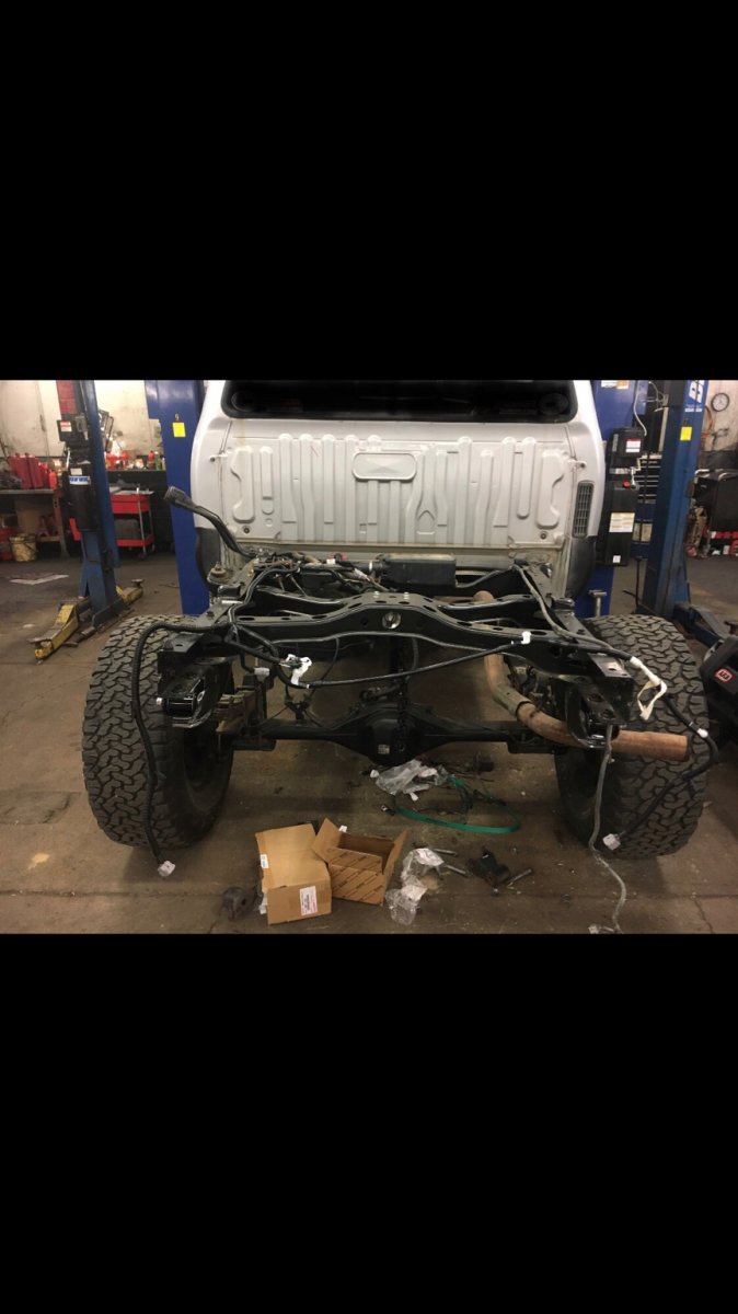

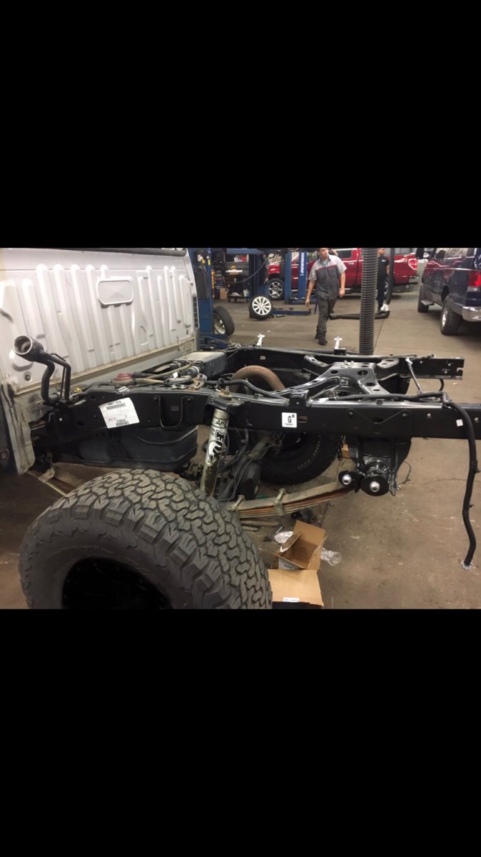

They are replacing my frame right now. So for now I get to cruise around in a brand new Rav4. Lol. Needed to fork out $1400 for a new exhaust system cause it was rusted so bad :| but they are covering the labor. They had it taken apart in about a day and a half. I'm sure it'll take much longer to put together.
