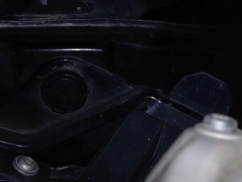

It will take you less then 5 min to remove it. Open your hood and look for the 2 screws on top. Then look by your head lights and look for the plastic insert. Use a flathead to pop the top up the pull them out. Almost underneath those 2 are 2 more at the bottom. Once you remove the 2 screws and 4 plastic insert clips your good. There are 2 tabs on the bottom that you can push down on while pulling on the grille. I'll send pics if you want. Just let me know.

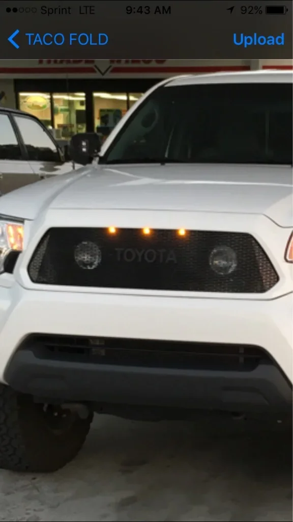

ImageUploadedByTaco Forum1449241011.700494.jpgImageUploadedByTaco Forum1449241050.071286.jpg

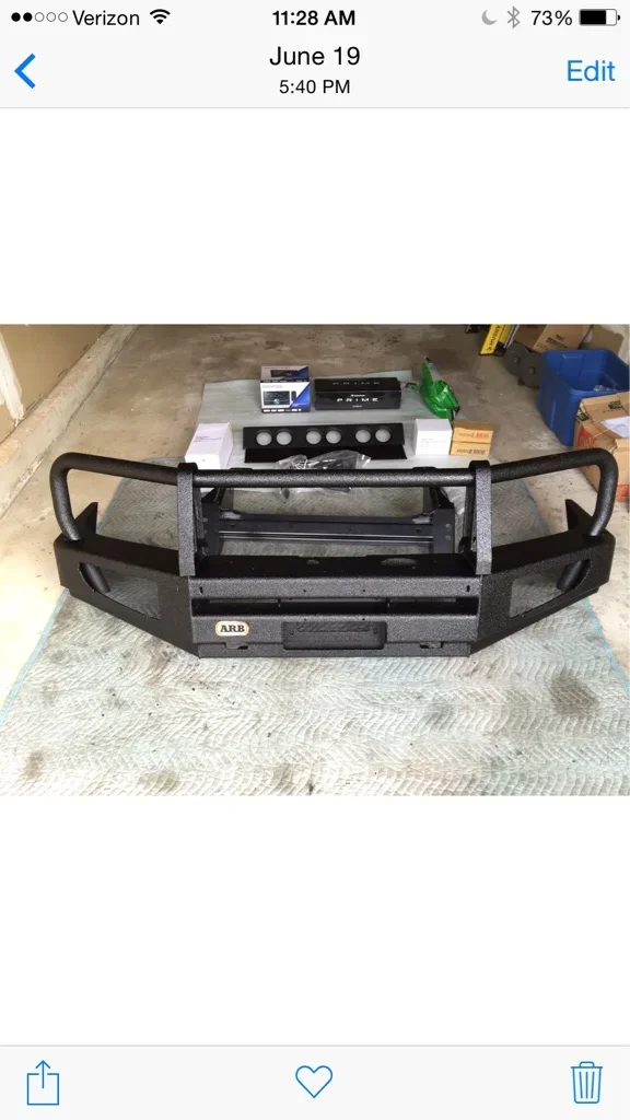

I installed my bumper Father's Day in 90 deg heat after my 3 rd left shoulder surgery 2 months before! The grill will be a quick and easy for you!

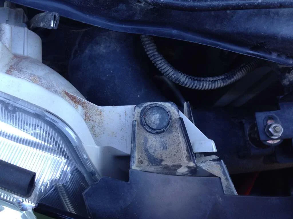

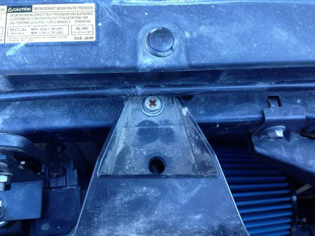

ImageUploadedByTaco Forum1449257111.542439.jpgremove this screw and the other one on the other side of the hood latch. ImageUploadedByTaco Forum1449257163.938944.jpgthis one and the other side. ImageUploadedByTaco Forum1449257216.416776.jpgthis is the one I was telling you about under the headlight assembly with the tab. Push down and out for the tabs. Hope this helps.

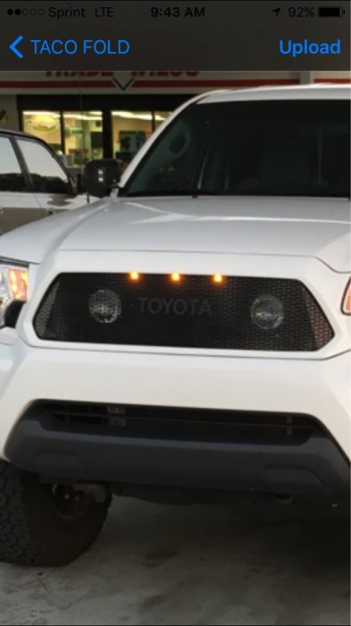

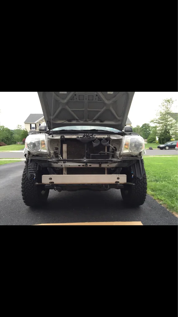

Finally Got around to getting it put on. Was so simple..ImageUploadedByTaco Forum1452023968.209183.jpg

They sell the grill with cut outs for 2 square mounted lights how they mount them is unknown by me..
