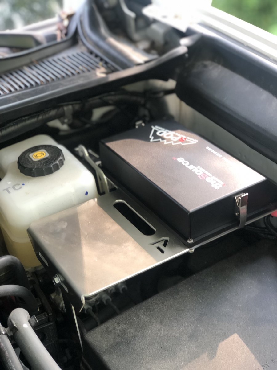

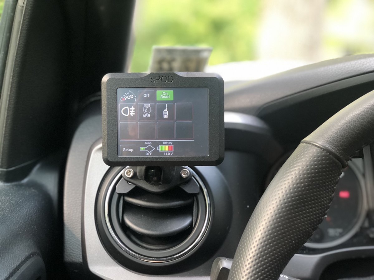

I just finished installing an sPOD SE in mine. 5th one I’ve put in my vehicles. Definitely fuller price way to go but they always work and get rid of superfluous wiring.
Basically you’d install it (or a Switch Pros, etc) in the engine compartment (I used a Powertrays bracket), wire it to the battery and pass the cable for the switches or touchscreen through the firewall.
Any light (or almost accessory) you add just needs to have the positive and negative wire run to the base in the engine bay. no other fuses needed for lighting just a positive and negative.
I went with the touchscreen this time mounted on a Ram ball/Hondo Garage mount.
and that’s it. nice, clean engine compartment and easy install of additional lights, etc.
