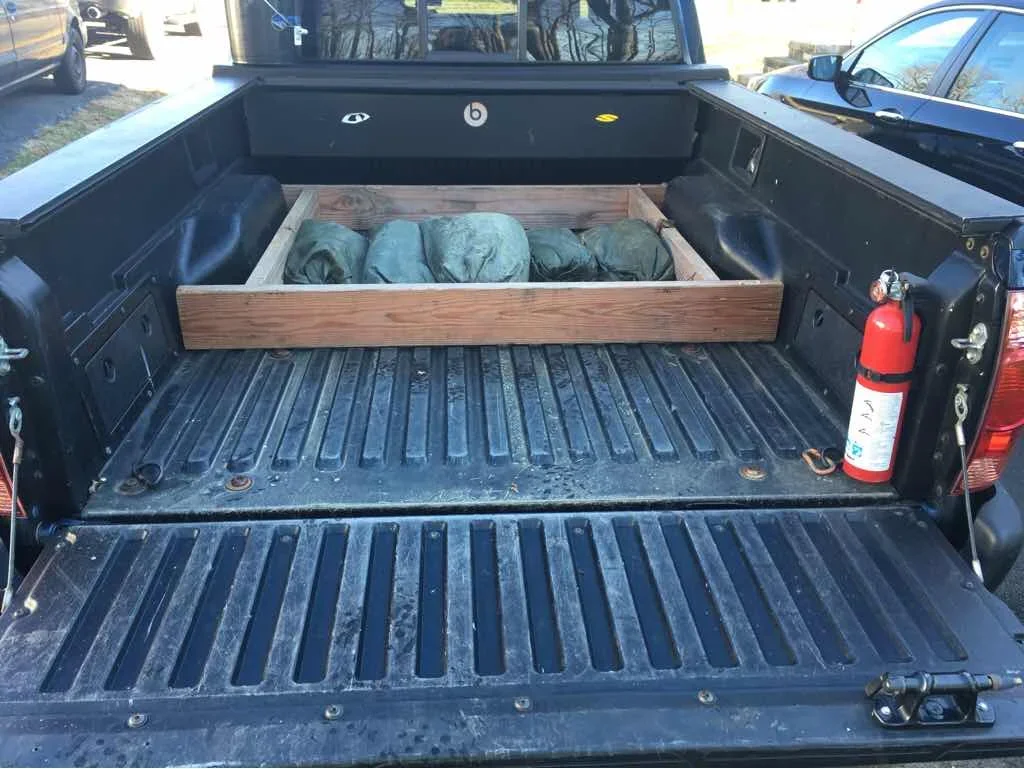

Frame out a box out of 2x6 to put in ur bed. Make it so that the front and rear boards r long enough to span from one side of the bed to the other and the side boards just long enough to get the end pieces to either side of the wheel wells. Then load ur weight in the box. Keeps ur weight over the wheels (where u want it), keeps it from sliding, and also gives u a nice area in the back to put 5 gallon buckets of road salt just in case. As far as driving tips on ice...dont do it if u dnt have to. Even with chains or studded tires ice sux! no matter what.

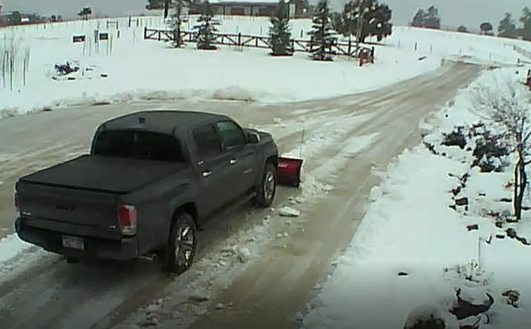

I'd strongly advise driving slowly (at first) to the nearest beach. :eek: As a guy who has lived in Alaska and other snowy places for decades, the caution of driving slowly is foremost. Don't be a ditch diver. The stock Michelin LTX tires on my 2017 Tacoma Limited have provided excellent traction - very happy with them. I carry 240 pounds of sand bags tied to the loops at the rear of the truck to balance my snow plow. I engage 4WD Hi when on icy spots and snow covered highways. That's what it's there for. Ya paid for it, ya may as well use it!
