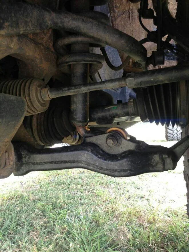

The picture included is why I wouldn't run a spacer lift of any kind. 5100s are cheap. Even if didn't wheel I would go for 5100s. On a budget? Don't lift.

That picture above looks like it may have an interesting story to go with it. I am betting that someone went airborne and came down on it to hard/fast putting it into a bind.
The bump stops would have prevented the shock from bottoming out but since the shock was pushed down it bottomed out before the bump stops touched.
that's not caused by a spacer lift that's caused by extreme and I repeat extreme abuse and I repeat Bow and Luke Duke style I've been in the automotive industry long enough to know what it takes to do that
That was caused by the spacer. Same thing happened to one of the TW guys at a Cleghorn meet. He came down hard and it bent like that. The spacer brings the whole coilover down which causes it to bottom out before the lower control arm hits the bump stop. If the spacer wasn't there the bump stop would have worked properly. Yes if you hit hard enough you will cause damage no matter what but the spacer makes it easier to break crap. No one will ever learn though. 30K truck and they put a cheap lift on it. I'll never understand.
But he "came down hard on it" im not sayin this is the best way all im sayin is he should have went a different route if he was going to playin that hard for the mud runners and drivers they work just fine i have 4k+ miles on my kit and play hard in it again pick your kits for what you do in it
