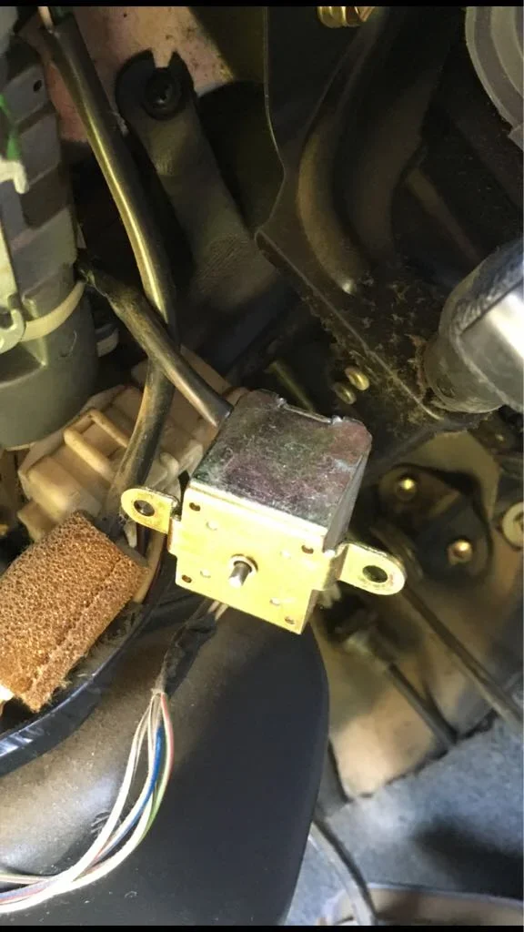

Hey everyone! My 1999 tacoma started having trouble with the key getting stuck in the ignition and would refuse to come out unless I disconnected the battery so I looked into everything I could think of and check all different manner of things I thought it could be long story short with the help of a friend we tracked it down to this part in the picture we believe it's called the ignition interlock solenoid I've been trying to track Down a replacemt for it but have had no luck any ideas where I could find it y'all? ImageUploadedByTaco Forum1498182475.122593.jpg
Check with the dealer. The price might hurt but they can probably get one.
Call and get the part number and google that part number you could probably find it cheaper.
Go to a U-pull it.
