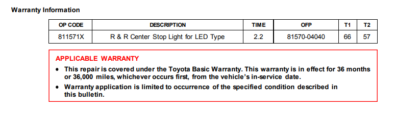

I just came across this TSB on NHTA
CRAP I CANT POST LINKS YET
(OP just paste this in the search bar of GOOGLE and it should be the first one that pops up. )
MC-10154796-9999 :)
Covered under warranty!!
2016 Tacoma. Rain last week in NJ. Noticed my rear seat was wet on the drivers side and it looked like dripping down rear window. Thought it was from the rear slider. Found the TSB listed on another Tacoma forum. Called the dealer and they played dumb. Scheduled an appointment for service, figured I could have them reprogram the transmission as well, since that's also a TSB. Dropped it off yesterday, they called mid-day to tell me it's definitely leaking from the 3rd brake light. Unfortunately, 3yr/30 warranty has expired and will not cover. Have to order parts and it will be $680+, which my reply was, "To change a light gasket?" "It's 3hrs labor, blah, blah, blah."....."Does it come with a new headliner?"...."No."
Needless to say, I reluctantly gave approval to fix it. What pisses me off the most, I purchased it used from this dealer in Nov '18. Had it in for replacement of the dashboard instrument cluster in the spring of '19 and looks like the TSB for the light was published in July '18. If it had occurred sooner, it would have still been under warranty repair.
