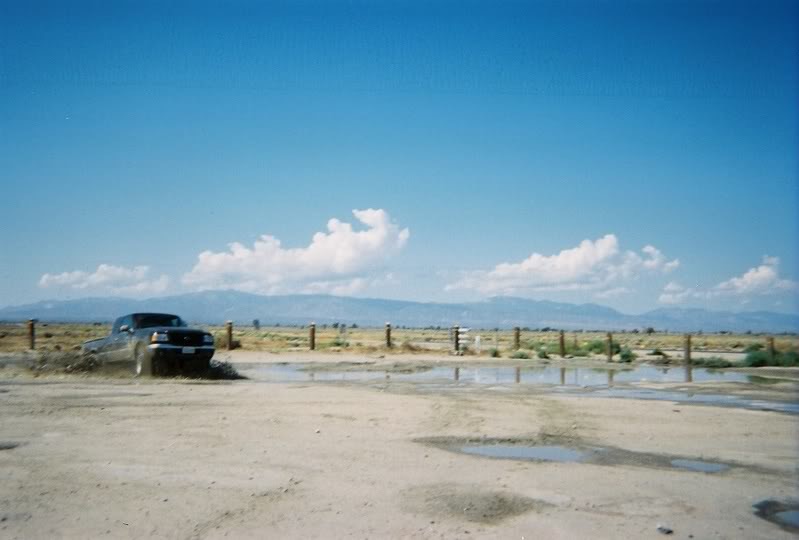

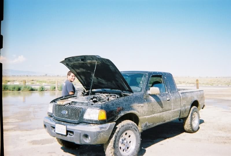

I had water high enough to soak the air filter which draws air from directly behind the passenger headlight in a Ranger. I even got stuck and had to back out but never had clutch issues while doing so.

I've never had an issue with a clutch in water or mud either. I'd recommend not shifting gears if you think your trans may be under water, especially muddy water. Just in case is not water tight, don't want any grit getting between the clutch mating surfaces.
